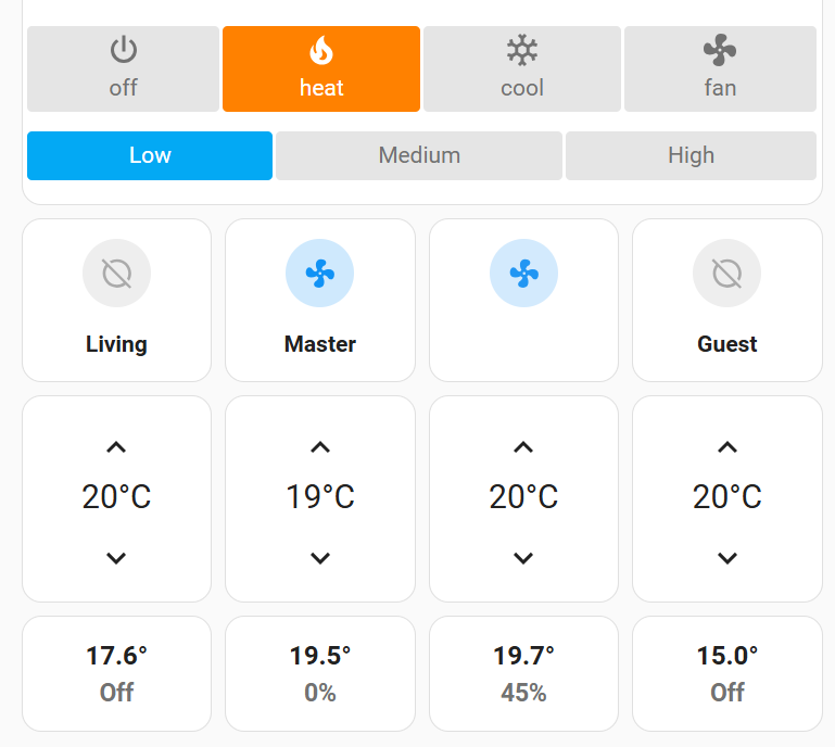

Been using the integration for a while, one thing I reckon would be handy to have exposed to HA is the current % the dampers are opened at any one time.
I have temp sensors in my zoned rooms, so I see the temp displayed on the main airtouch unit. But a few times I’ve wanted to see what the actual damper % was open - cases where a room has reached and is above the target temp but I’ve felt air still coming from the duct - had to go to the airtouch and login to the service and look at what the damper % was.
If you’re using the custom integration, there are sensors that show the current damper percentage
My main dashboard exposes the damper percentages so I can see them easily. I can share this if anyone wants it, I took a dashboard someone else made and extended it.
I also have some automations that do things like close down dampers if the room is 0.25C over the setpoint and the damper is relatively wide open. This shows how to access damper percentages. I have some more example automations here.

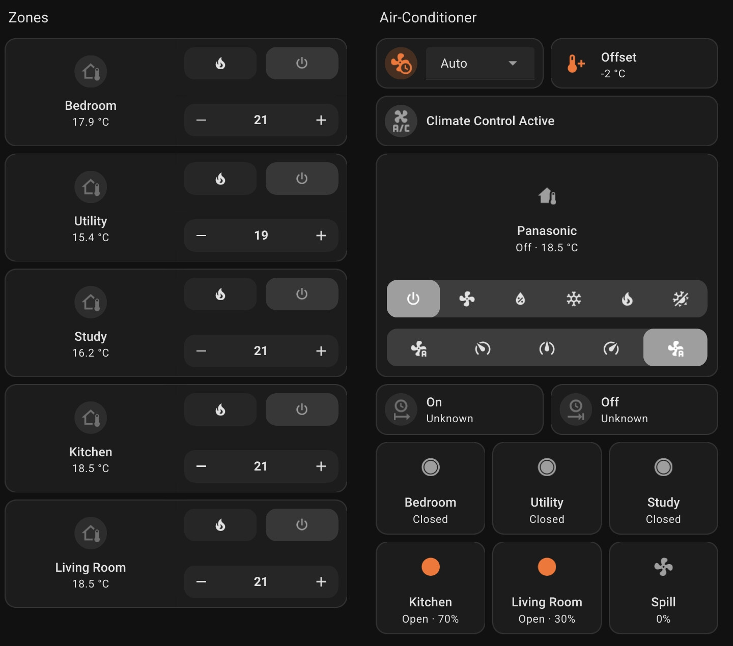

I just use Mushroom Entity Cards for the on and off timer entities and gave the off timer card a tap action that sets the timer in 30 minutes. Opening the details page for the time entities lets you enter an exact on/off time.
Dashboard looks like this:
Timer entity cards are:

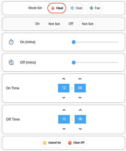

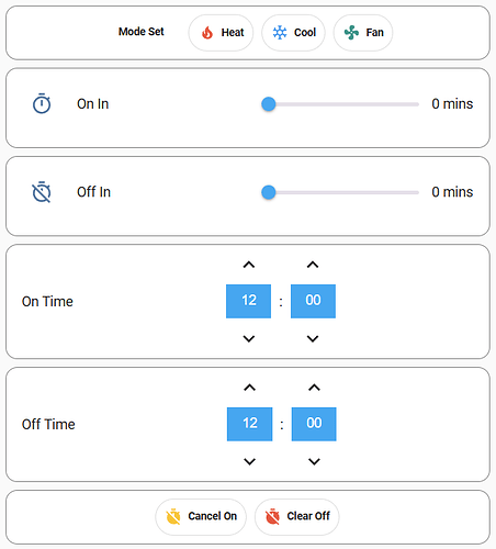

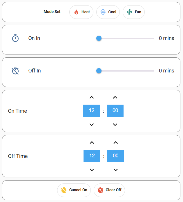

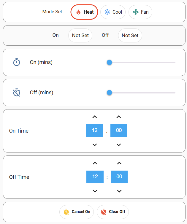

Interesting, thanks Ben. I wanted more direct control from one dashboard, so I built a power control dashboard that uses with the Airtouch built in timers via your component. I probably won’t use it quite like this, I’ll integrate the parts I need into the main dashboard, but I put it all together so others could use it like this if they wanted to.
If anyone’s interested I can put it up on GitHub, once I test it a bit more. To use it you’d need a couple of custom components, and to edit the configuration to add some input fields and sensors, plus there’s four automations and two scripts to wire it all together. AI couldn’t write the dashboard for me, but it made it a bit faster to create some of the blocks.
I’ve put my Airtouch Timers dashboard and related automations / scripts / config changes onto Github. It’s new so there’s probably bugs, but it works ok. Comments / pull requests welcome.
