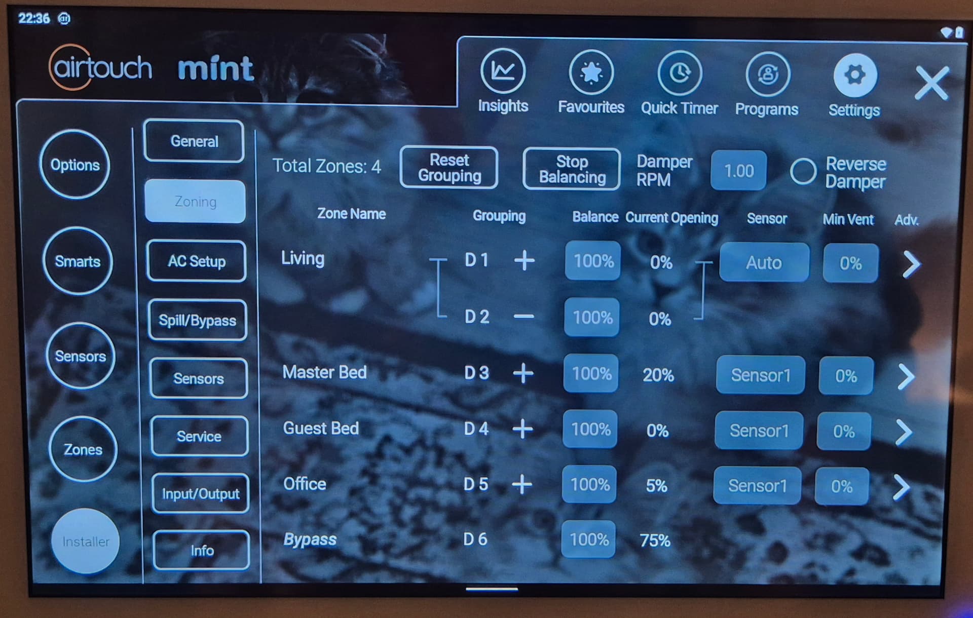

Hi gents, I’ve been experiencing this recently when running the cooling. Our bedroom is randomly going full blast at some ungodly hours (2:00-4:00am) despite it not experiencing elevated temperatures. Seems to happen regardless of whether I open the dampeners to other rooms.
I have a bypass fitted. Was wondering if the two of you do? I don’t quite understand why this is happening.
It’s because at some point your system has cycled off, your room has started to heat up and the Airtouch is adjusting the damper position open, the room temp rises it opens more until the point of which it sees the room temp start dropping again.when the cooling starts.
You do get brief times the bedroom hits 100% and the bypass closes, even mine use to till I set the max opening back a little less and I never have any issues.
If you have a bypass then you can get away with balancing the system to a max opening percentage anyway so adjust that room to a level where it’s open enough that the noise is less and this will still cool the room any other time.
That’s the correct way to do it, don’t try automate around it.
Yep, ok, that explanation makes sense given that this has only started occurring in the shoulder season.
i did look for something that would allow me to set the max value for a zone damper, but could only see the “Min Vent” value settings. Or do I just lower the “Balance” value for that single zone? Is it that simple?
Yeah lower the balance value from 100.
