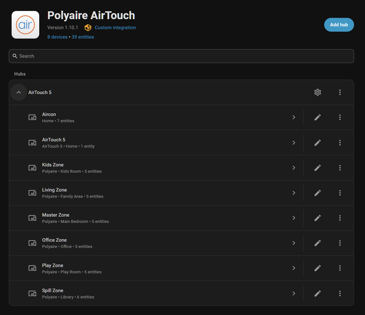

Hi all,
I’ve deleted a zone in my airtouch 5. How do I update my integration it’s still being listed there?
Spill doesn’t exist it doesn’t have a controller.
Hi mate, I have them here, I just got the stickers for them today.
I’m just revising and double checking all the code and features over the next week and they will be ready to send out.
You can just delete the top-level AirTouch 5 hub and then re-add it. The remaining zones will be recreated with the same unique IDs so automations and dashboards won’t be affected.

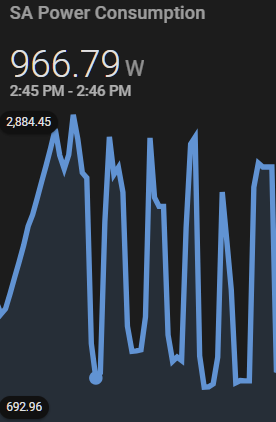

does airtouch control the Hysteresis in the AC? I’m trying to smooth out the power consumption but it’s currently jumping between 900 and 3KW
ideally I want to smooth this to fly just under my solar generation
The logic of the Mitsubishi system is controlling the ramping up of the system, my device helps get rid of these peaks and would stop it going so high when you don’t want it too. I can stop it going over 2kw and maybe a little lower being a 12.5kw
