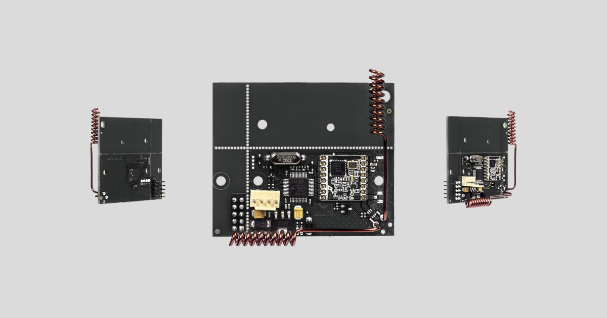

Is AJAX uartBridge transmit door state and alarm information or alarm only ?
Can we use the uartBridge within parallel of AJAX Hub ?
Devices on uartBridge will be not available in Hub. So, bridge is looks like the ā€œoldā€ hub

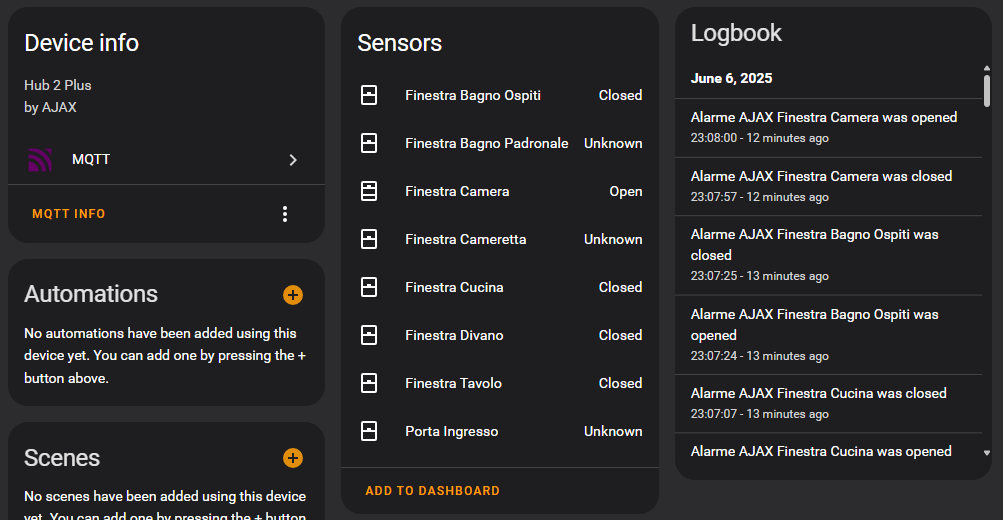

Since nobody is helping, me and @riki90 found out how to do this.
I feel it is correct to share: follow this guide and you’ll have all your doors and other sensors to communicate directly (via MQTT) to HA.
Skip the first SIA part, jump over the second one (Jeedom).
Spoiler alert: not the easiest path, but if it works it is a great accomplishment.
Just ignore the two ā€œunknownā€ states. It’s late and I cannot open and close that doors/windows.
I can help in case of troubles.
