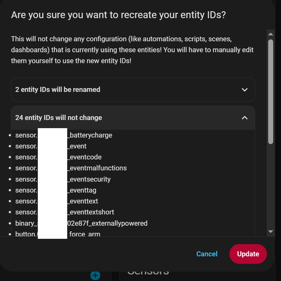

Can I change entity_id’s once they have been created without affecting integration functionning?
Yes, I rename my without problems
Thanks. I noticed entity_id’s cannot be recreate automatically. Is this something that may be improved? I removed the serial id of the Hub in this case.
I do not know how to do this. Some old versions of HA ask me to rename all sensors with device rename. I can change it, if someone point me how to do it.
