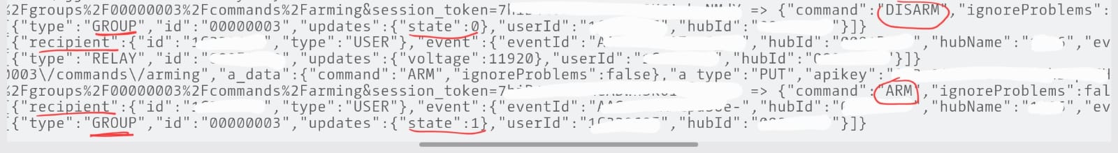

This is from from jeedom log. There are two messages after each arm/disarm event. In my example I do disarm / arm to take log.
First one for GROUP state and second, starting from recipient, is Hub SECURITY event. I take armed/disarmed information from both of them.
To understand what is going wrong I need to look on them. I do not need hub id, user if, tokes, etc. But need groups id (it’s just number from 0000001 to 0000004). My hub model is Hub Plus, maybe it has different information for other models
