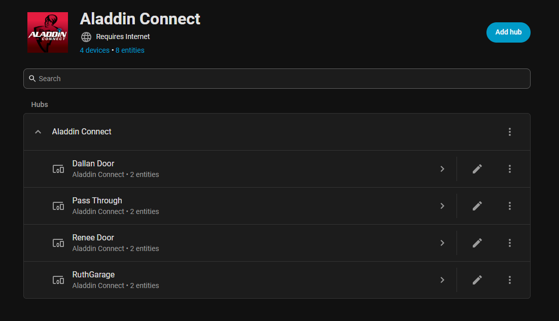

I think Aladdin Connect integration is having some sort of problem. It appears to be showing devices that do not belong to me. It’s randomly updating the device list and it seems like other people garage door covers are showing up on mine. Not to mention my own cover device disappeared. Wondering if this is happening for anyone else also.

Same here — ~420 other people’s garage doors appeared as cover entities. They also got exposed to Alexa via Nabu Casa and showed up as unresponsive devices in the Alexa app. Cleaned up HA (removed the entities, reloaded the integration, then disabled it), but the Alexa devices persist even after disabling the HA skill for 2 hours. Amazon support couldn’t help. Has anyone found a way to purge them from Alexa in bulk?
