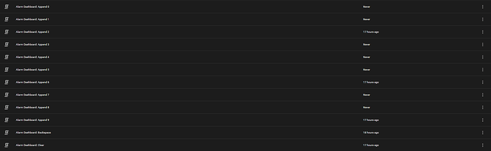

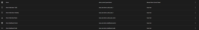

There are the helpers that I have currently:
And here are the scripts that it created:
Wait, never mind. I fixed something by just redoing the blueprint like 3 times lol. It seems to be fully working now!
Good to hear it was fixed, not sure what went wrong though :smiley: .
