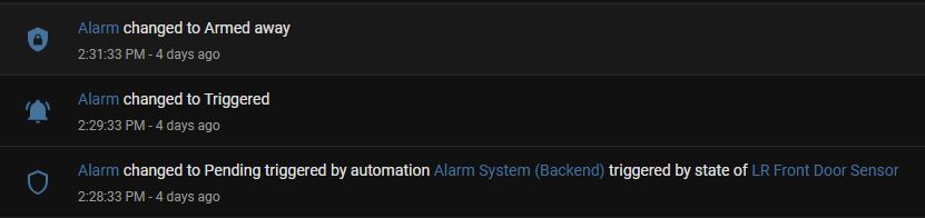

So, when my alarm gets triggered by a sensor, it gets almost immediately dismissed and the mode switched back.
Is this a current problem, or is my config just wrong?

I think it’s 2026.01.2 for MACP (according to the version history) and 2026.03.1b3 for HA Core. I am using a dashboard keypad, and it always does it on Armed Away, since I don’t currently use the other states, other than Disarmed, Armed Away, and Triggered. I also redid my entire blueprint just to be sure.

Okay, but the thing is, it’s been happening for a while, not just for this update…

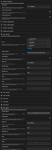

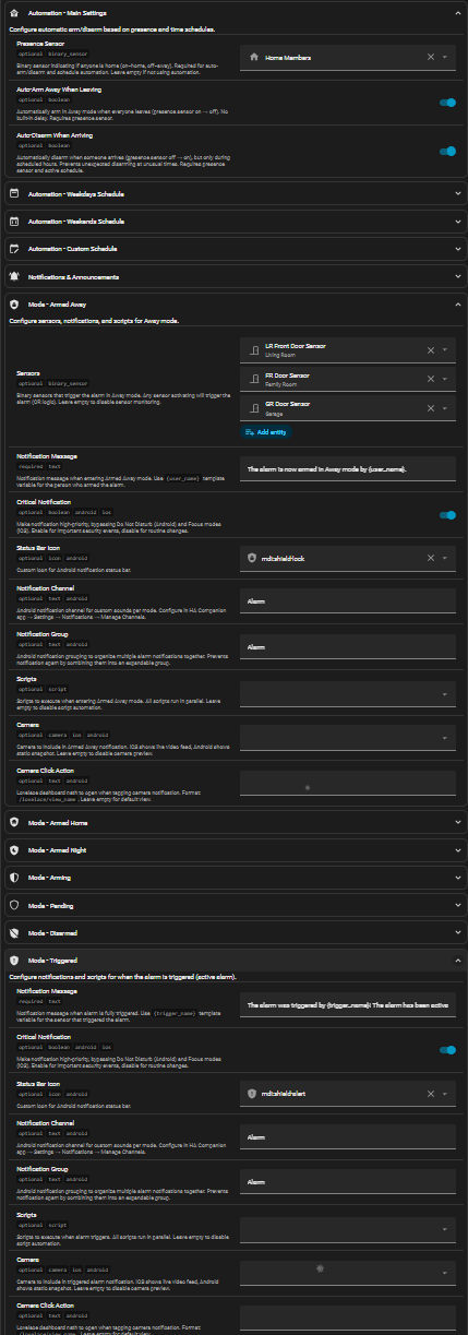

I got as much as I could. I didn’t really configure much, so I’m just showing what’s necessary related to the arming and triggering.
This is not readable.
Can you click on the three dots in the top right of that menu and click on Edit in YAML. Copy all the text and paste in a reply.
Mark it as preformatted text in the post, so it is easier to read.
