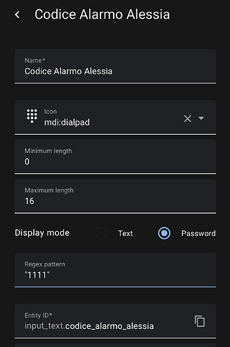

Hi!
I use Alarmo, and in Alarmo I have set up 3 users with 3 different codes.
I created the Helpers in Home Assistant with the same codes, and inserted them into your blueprint.
When I enter a code on the Frient keyboard, nothing happens. Can you help me?
Thanks

You have not set the regex pattern correctly for the helper. The regex pattern should include numbers 0-9 and letters A-F, if you afterwards only store numbers inside the helper, it should still work as that’s how I use it with the manual alarm control panel. With the regex pattern you have set now I think it can only store 1111 as code.
If you still encounter errors after that, can you share a trace of the automation showing what the error is?

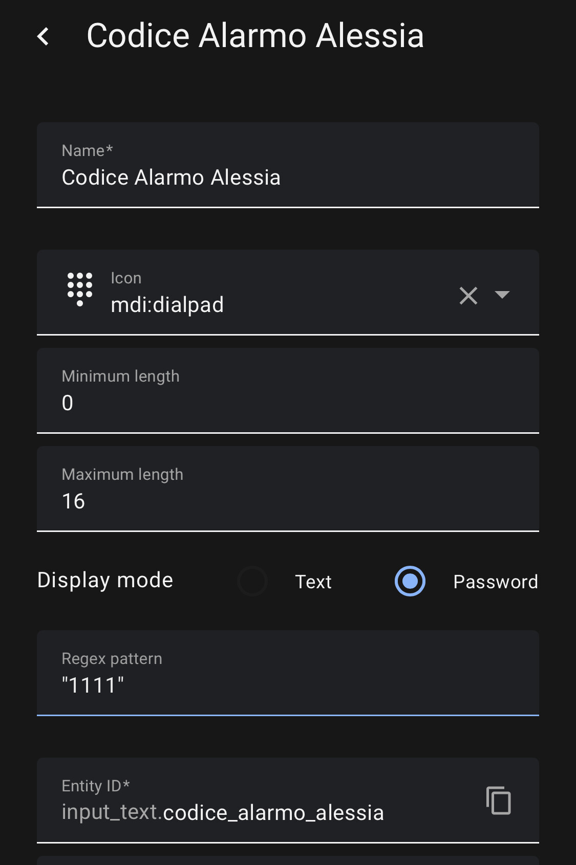

The input_text is set exactly like this
Once again, your regex pattern is wrong. Read my instructions. If it still fails after that, please provide more information to be able to help you.
