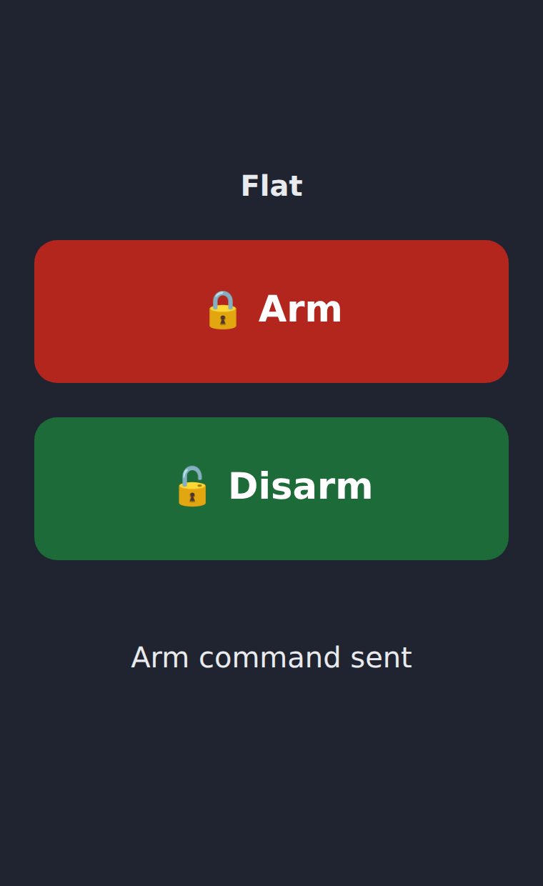

So this gives each person a URL. They open it, they see two buttons.
Add someone → create an automation from this blueprint. Remove someone → delete it. Their link stops working immediately and nobody else is affected.

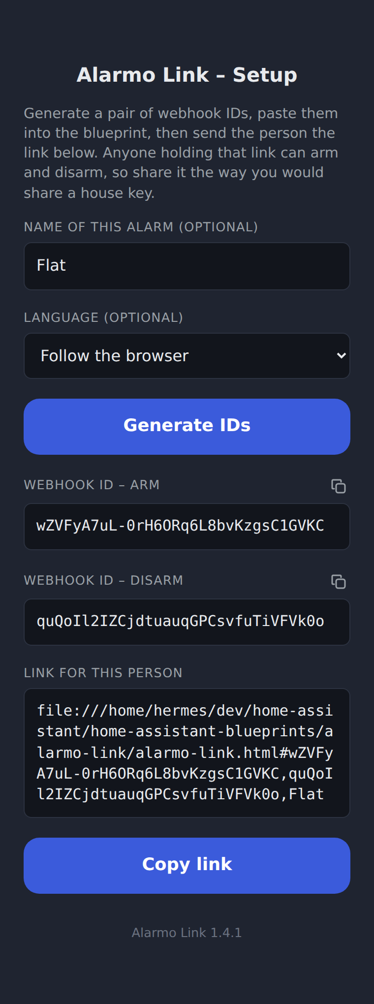

  1. Copy alarmo-link.html to config/www/alarmo-link.html
  2. Import the blueprint with the badge above
  3. In Alarmo, give the person their own user and code — Alarmo’s history names the user the code belongs to, so a shared code names the wrong one

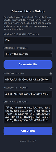

  4. Open https://<your-ha>/local/alarmo-link.html with no # in the address. That is a setup screen: it generates a pair of webhook IDs with crypto.getRandomValues and shows you the finished link
  1. Paste the two IDs into the blueprint, add the name and the Alarmo code, save
  2. Send the person the link. Add to Home Screen turns it into a full-screen icon
Optionally the link carries the alarm’s name and a language, both independent: #<arm>,<disarm>[,<name>][,<language>]. The heading, the tab title and the home screen name follow the name; English and German are included and anything else falls back to English.

  • No API token in the page, which is why it says “Arm command sent” rather than showing the alarm’s real state. Showing real state would mean putting a token in a page that has no login — that is full access to Home Assistant, for a two-button panel. Not worth it.
  • A revoked link still reports success. Home Assistant answers 200 OK for a webhook it does not know, deliberately, so nobody can probe which IDs exist. The page cannot tell that apart from a real success. This is why the notification option matters: two seconds after the command it reports what the panel actually did, and it is the only confirmation there is.
