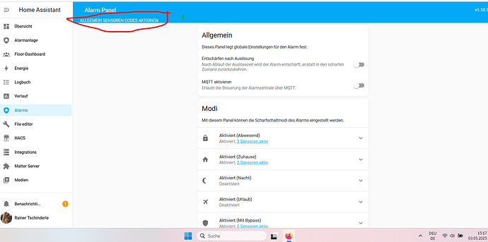

does anyone have the same problem or got an solution for me?
Since today my alarmo-side-panel was not reachable.
At least i reinstalled alarmo and now i got the Side Panel Configuration Page without the Links to “Allgemein - Sensor - Codes - Aktionen”. I cant configure ist…
This is how it schould be:
And this is how mine looks now, no possibility to click on the Tabs to manage it:
Mine’s still working as expected. Can you give us more details of your setup - version numbers etc.
Antalor
(Rainer T.)
May 3, 2025, 2:55pm
3
i use Alarmo vers. 1.10.7 on a Home Assistant Yellow, Homeassistant is current, no available updates at the moment.
Same Alarmo version as me.
tom_l
May 3, 2025, 9:07pm
5
Configuration page taking ages to load for me on 2025.5.0b2, then when it does load the top menu is non functional.
Edit: I opened an issue:

tom_l
May 6, 2025, 10:52pm
6
There is some advice here about using the direct URLs to reach the configuration pages, as it will take a little while to fix.
