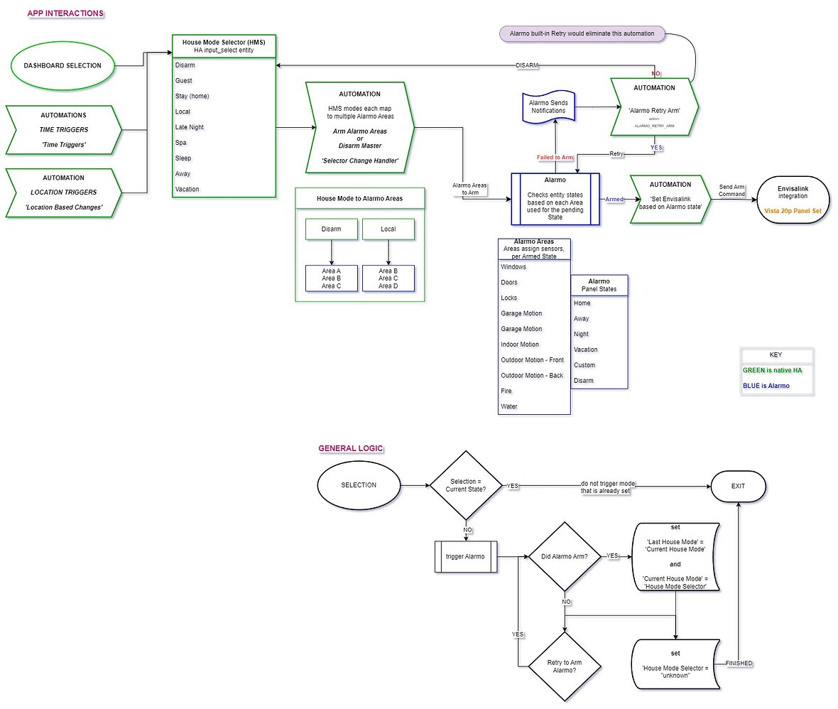

I run both… I combined the a wired/wireless Honeywell system with a complete custom House Mode system (automations, helpers, etc). It is a complete state system that will arm/disarm and notify based on who is home (person location, door lock codes used, etc)
I use Alarmo only because I started using it thinking it would do more than it really does. It cannot handle House Modes so I will remove Alarmo when I get around to it. In my diagram you can see it only does sensor checks when arming – so I’ll replace with native automations soon.
Alarmo is good if you want a basic virtual ‘alarm’.
