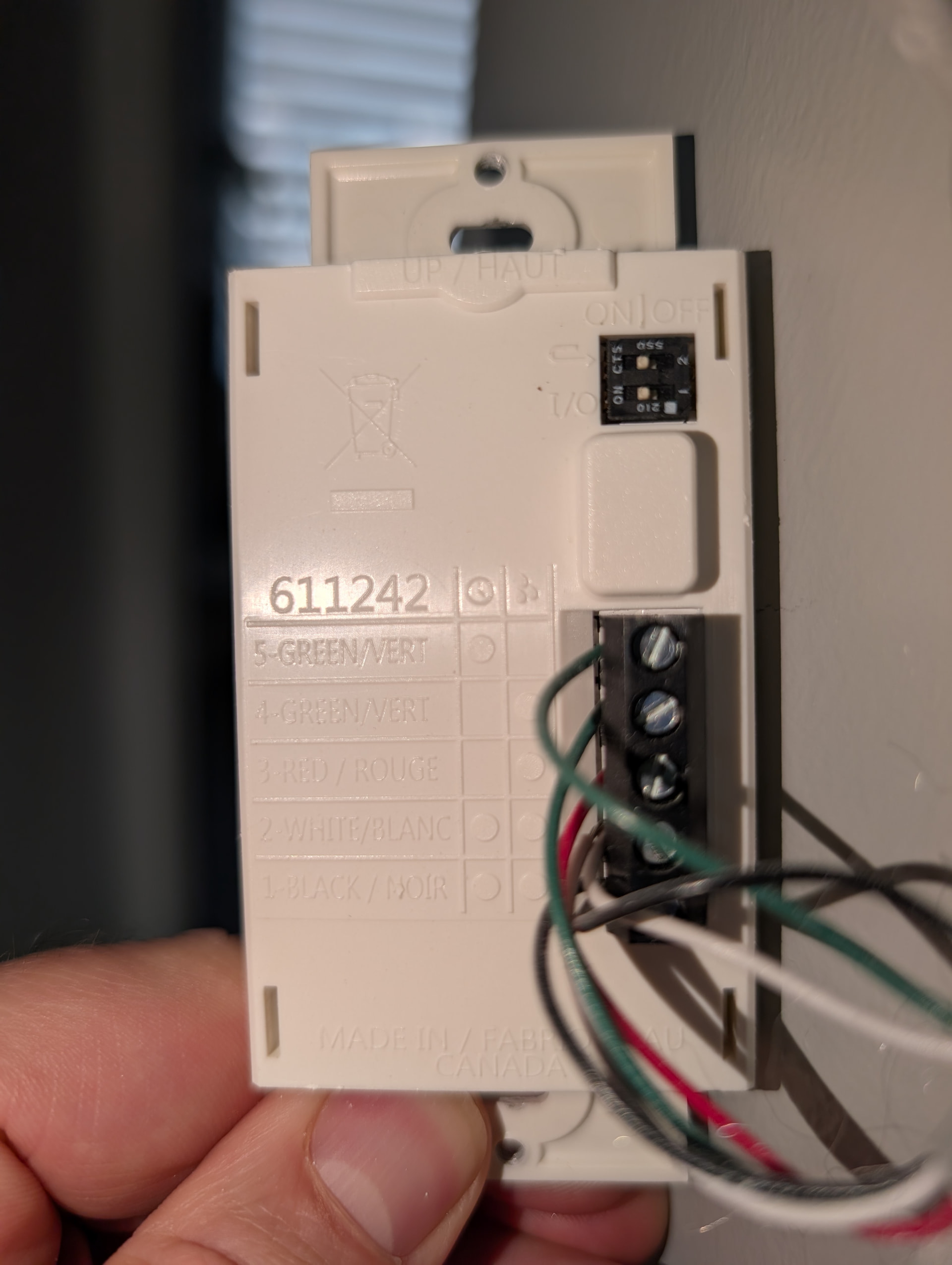

The exact model. There is no 61124 in the Aldes literature — 611242-FC is the digital multifunction control, and that one may talk its own protocol rather than close contacts. Look at the label on the back of the plate.
A photo of the terminal strip inside the unit. Recirculation is the part I would not assume: boost is documented, a dedicated recirc contact is not, so it may not be reachable from the wall control at all.
I missed a digit when I typed it in.
Here is the back panel.
With the right number, 611242, my earlier answer changes. It isn’t a simple switch on the wall. It has its own power, 22 to 26 VAC, and it sends that 24 V back out to the unit to ask for a speed. On the back, terminal 1 (black) is the 24 V coming in, 2 (white) is the common, 3 (red) calls high speed, 4 (green) calls low, and 5 (green) is where an Aldes timer would plug in. The two little DIP switches just tell it what kind of unit it’s attached to — one is recirculation on or off, the other is electronic versus free cooling. Set them to match your ventilator; they have nothing to do with Home Assistant.
I wouldn’t try to hook into the wall control itself. The easier place is the ventilator, which has its own low-voltage terminal block with eight terminals, and there it’s just contacts you close: 1 to 3 gives you low speed, 1 to 4 gives high (there’s a jumper between 3 and 4 for that one), and 1 to 5 is the boost. So three relays on any ESPHome board, wired alongside the existing control. The wall control carries on working exactly as it does now.
