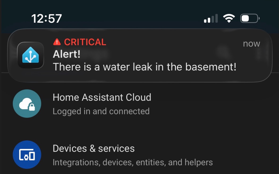

Use Case
Wet Basement Alert
Receive a repeating notification when the basement has a leak and optionally turn on a light to indicate that there is an alert.

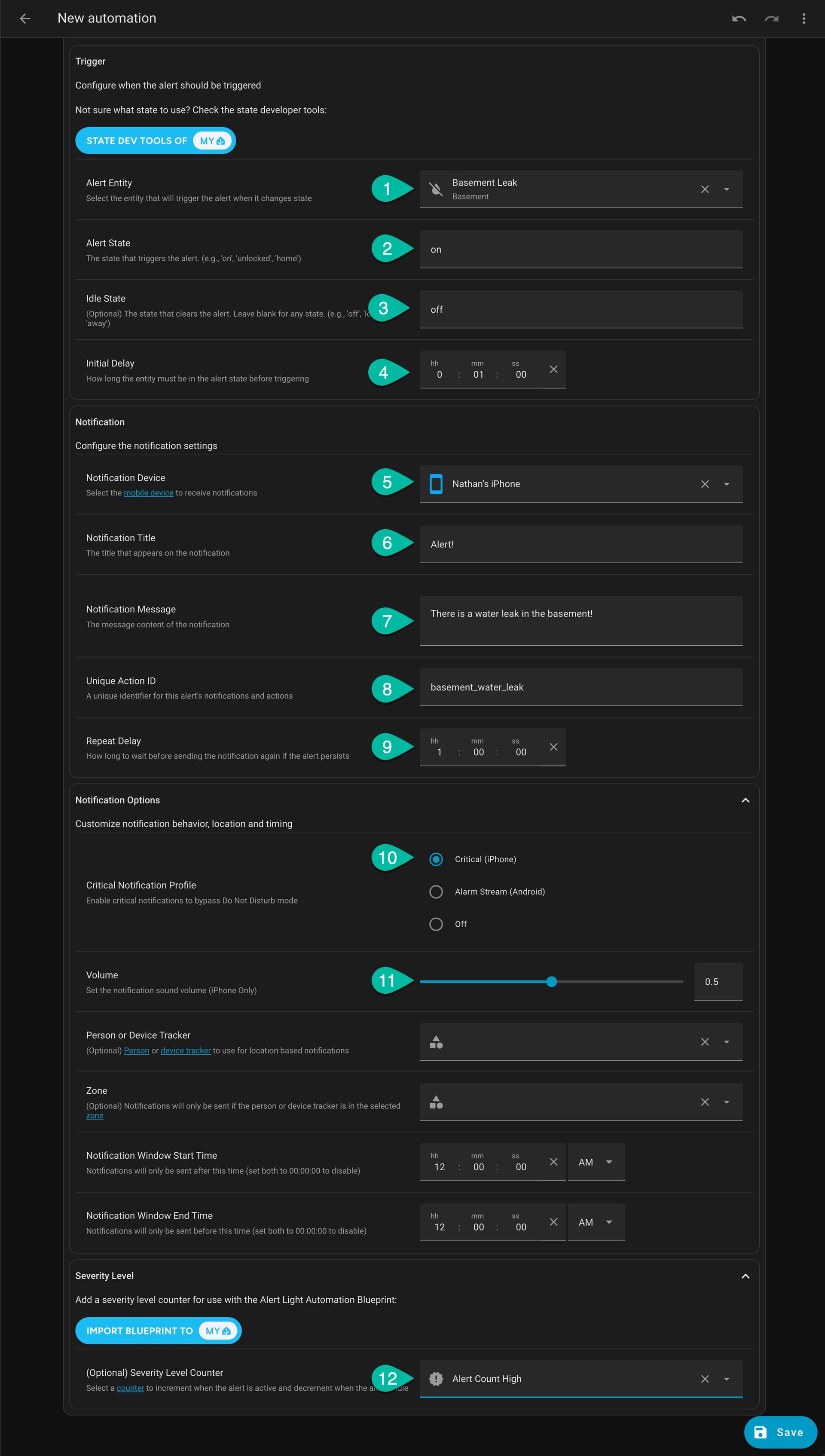

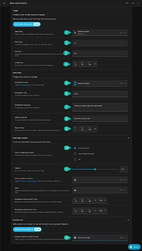

Requirements
Setup
  1. In the Alert Entity field, select the water leak sensor for the basement.
  2. In the Alert State field, enter ‘on’. Since this is a binary sensor, the sensor is ‘on’ when water is detected.
  3. In the Idle State field, enter ‘off’. Technically we could just leave this field blank, then any state other than the alert state would stop the alert. But in this case, we want a positive indication that water is no longer detected.
  4. In the Initial Delay field, enter 1 minute. This will act as a debounce to prevent rapidly repeating alerts as the water sensor dries.
  5. In the Notification Device field, select your mobile device.
  6. In the Notification Title field, enter Alert! or whatever you’d like.
  7. In the Notification Message field, enter There is a water leak in the basement! or what ever you’d like.
  8. In the Unique Action ID field, enter basement_water_leak. This value just needs to be unique from every other alert.
  9. In the Repeat Delay field, enter 1 hour
  10. For Critical Notification Profile, select the appropriate platform. For me, that’s iPhone.
  11. For Volume, 0.5 is not too quiet but not too loud.
  12. In the Severity Level Counter field, select your High Alert Counter. This is optional and requires the Alert Light blueprint.
What Will Happen?
Hopefully nothing! Nobody wants a wet basement.
The water leak sensor changes to ‘on’ and stays on for 1 minute:
  1. The alert automation triggers.
  2. The severity level counter is incremented, turning on the light specified in the Alert Light blueprint.
  3. Since we did not set up a zone or a time window, a notification is sent to your phone immediately and bypasses Do Not Disturb.
  4. The automation now enters into a waiting period for 1 hour and will wait there unless the water sensor reports ‘off’ or the alert is dismissed from the notification.
  5. Let’s say 1 hour passes: another notification is sent to your phone.

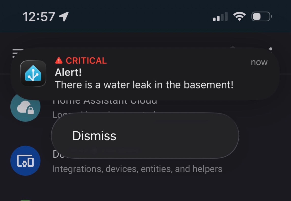

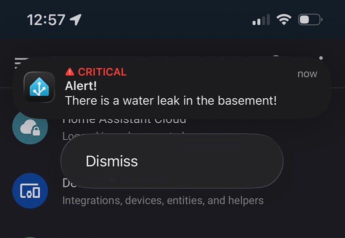

  6. If you want to dismiss the alert, you can long press on the notification and select dismiss.
  7. If you dismiss the alert or the water sensor reports ‘off’, then the severity level counter is decremented and the automation stops.

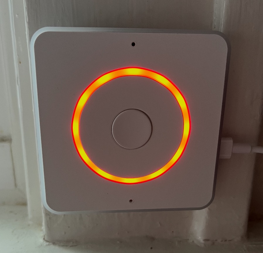

Great questions! For me, my Alert Light is all the Home Assistant Voice PE’s in the house. And there can be multiple alerts per day. Here’s a run down of a typical Saturday:
8:00am - if the lizard enclosure has not been opened that day, activate the Lizards have not been feed alert. Send notification to my youngest son as it’s his job, HA voices light up yellow as it is a medium alert.
10:00am - if trash cans are not at the curb active take out trash cans alert. Would normally light up green because it is a low alert, but there is a medium alert active, so no charge there. I get a notification on my phone.
11:00am rolls around, I see that the HA Voice light is yellow and ask “what’s up”, it reads out the alerts and I tell my son to feed the lizards.
11:15am - my son feeds the lizards and that alert is no longer active, the HA voice light turns green because there is still an active low alert.
12:00pm - the washer has been finished for more then 30 minutes but the door has not been opened, the Wet Clothes In Washer alert is now active, the alert light is already green so no change. My spouse and I get an notification if we are home.
12:30pm - My spouse moves over the laundry, alert is no longer active, the alert light stays green as there is still a low alert active.
1:00pm - I stop being lazy and take down the trash cans. The alert is no longer active and the lights on the HA voices turn off.
3 of 4 members of my household have ADHD and this automation set has made a huge impact on us getting these common tasks done in a timely manner.
