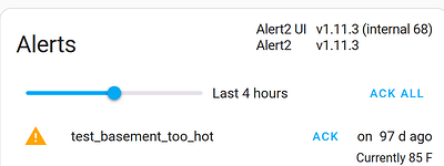

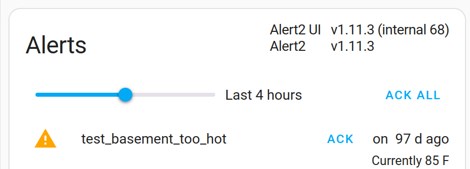

Hi @f18m ,
If you click on “Alerts” in the overview card to show the Alert2 backend version, do you see the v1.11.3 twice as in the following:
Did you add any configuration to the alert overview card, like setting filter_entity_id, that might be preventing it from showing the alerting entity?
In the logs, there should be a line something like:
2025-05-15 06:28:53.595 INFO (MainThread) [custom_components.alert2] Setting up Alert2````
If you don’t see something like that, then Alert2 isn’t loading when HA starts.
-Josh
