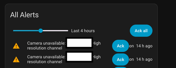

Hey so great to see some of my PR starting to make it’s way into the main branch! I was away all summer just getting back now. I’ll see if this fall I can try to get the tests working to try to get some of the rest of my PR tested (and see where we are in main vs. some of the changes I made). Looks like some good work has been going on overall!
I just updated to Home Assistant 2025.9 and now my ack buttons which were styled as blue links now look like big blue buttons. Any one else seeing this? HA must have changed styling in the dashboard?
