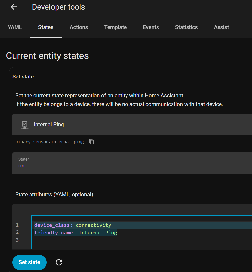

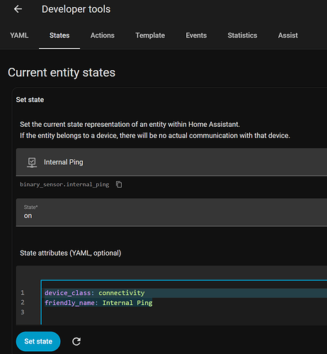

You can set the state directly in Developer tools when testing. This will be reverted to the real device state when the device next checks in. Useful if you don't wanna keep walking back & forth :wink:
