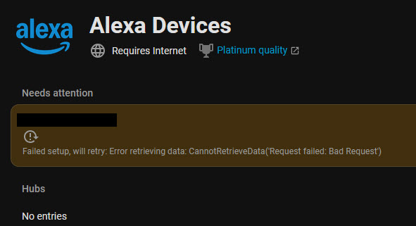

I tried to res-intall the integration multimple times. It was working before I’m not sure when it failed , maybe after one of the updates.
It’s returning this error : Failed setup, will retry: Error retrieving data: CannotRetrieveData(‘Cannot find account owner customer ID’)
I have followed the procedure and tried with 2 different accounts but same result. Please help I dont know what else to try
