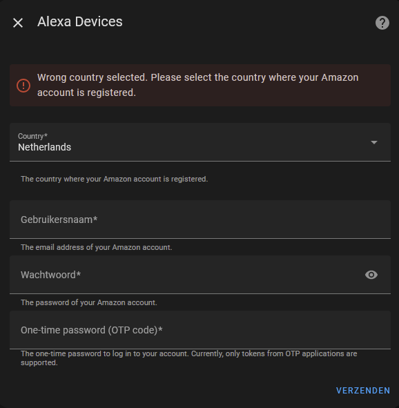

I have migrated all my devices from amazon.com to amazon.nl domain because Amazon recently added Dutch language.
Amazon region settings (logged in via amazon.nl) are set to “Nederland” → Netherlands
But when I try to (re-add after deletion) the integration I get the below error;
Home Assistant log says;
Logger: aioamazondevices
Bron: components/alexa_devices/config_flow.py:34
Eerst voorgekomen: 19:55:53 (1 gebeurtenis)
Laatst gelogd: 19:55:53
Selected country <NL> doesn't matches Amazon API reply: {'site ': 'https://www.amazon.nl'} vs {'market': 'https://www.amazon.co.uk'}
How to change the API call regio?
@woempiej, I have fix for that: fix: change country logic for fixing Brasil and Netherland by chemelli74 · Pull Request #393 · chemelli74/aioamazondevices

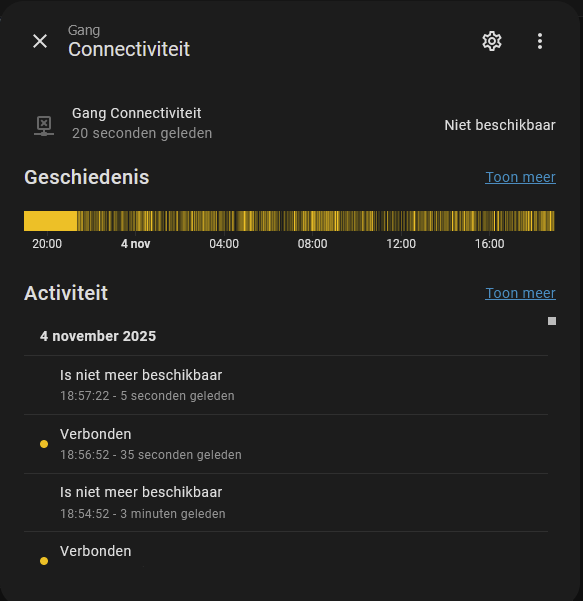

I have some problems since 1 week or so.
I got some error messages like the following…
Logger: alexapy.helpers
Quelle: runner.py:271
Erstmals aufgetreten: 08:59:03 (36 Vorkommnisse)
Zuletzt protokolliert: 13:27:33
alexaapi.get_devices_gql((<alexapy.alexalogin.AlexaLogin object at 0x7fc5947b5090>,), {}): An error occurred accessing AlexaAPI: An exception of type AttributeError occurred. Arguments: ("'NoneType' object has no attribute 'get'",)
alexaapi.get_network_details((<alexapy.alexalogin.AlexaLogin object at 0x7fc5947b5090>,), {}): An error occurred accessing AlexaAPI: An exception of type AttributeError occurred. Arguments: ("'NoneType' object has no attribute 'get'",)
Quelle: components/alexa_devices/coordinator.py:58
Erstmals aufgetreten: 08:55:48 (234 Vorkommnisse)
Zuletzt protokolliert: 13:28:49
Malformed sensor state data received: {'errors': [{'message': 'Too many requests', 'path': ['endpoint'], 'extensions': {'errorCode': 'UNOFFICIAL_CLIENT_TOO_MANY_REQUESTS', 'isRetryable': False, 'classification': 'DataFetchingException'}}], 'data': {'endpoint': None}, 'extensions': {'requestID': '124CP11462VVW643F4TE', 'duration': 15}}
Malformed sensor state data received: {'errors': [{'message': 'Too many requests', 'path': ['endpoint'], 'extensions': {'errorCode': 'UNOFFICIAL_CLIENT_TOO_MANY_REQUESTS', 'isRetryable': False, 'classification': 'DataFetchingException'}}], 'data': {'endpoint': None}, 'extensions': {'requestID': '20K0W7B42MQTKM5ZT8NW', 'duration': 14}}
Malformed sensor state data received: {'errors': [{'message': 'Too many requests', 'path': ['endpoint'], 'extensions': {'errorCode': 'UNOFFICIAL_CLIENT_TOO_MANY_REQUESTS', 'isRetryable': False, 'classification': 'DataFetchingException'}}], 'data': {'endpoint': None}, 'extensions': {'requestID': '8QF56787DCPJ0TR9WZT1', 'duration': 13}}
Malformed sensor state data received: {'errors': [{'message': 'Too many requests', 'path': ['endpoint'], 'extensions': {'errorCode': 'UNOFFICIAL_CLIENT_TOO_MANY_REQUESTS', 'isRetryable': False, 'classification': 'DataFetchingException'}}], 'data': {'endpoint': None}, 'extensions': {'requestID': 'Q79CVFCDDFDTKZPFPE0W', 'duration': 15}}
Malformed sensor state data received: {'errors': [{'message': 'Too many requests', 'path': ['endpoint'], 'extensions': {'errorCode': 'UNOFFICIAL_CLIENT_TOO_MANY_REQUESTS', 'isRetryable': False, 'classification': 'DataFetchingException'}}], 'data': {'endpoint': None}, 'extensions': {'requestID': 'QEA86FC0SE38ZN5RK0TD', 'duration': 15}}
Logger: homeassistant.components.alexa_devices
Quelle: helpers/update_coordinator.py:424
Integration: Alexa Devices (Dokumentation, Probleme)
Erstmals aufgetreten: 08:49:17 (139 Vorkommnisse)
Zuletzt protokolliert: 13:29:19
Error fetching [email protected] data: Error retrieving data: CannotRetrieveData('Request failed: Bad Request')
I still restart the integration but i didn´t fix the problem. I still deinstalled it and configured it new. But also this didn´t fixed the problem.
I am still using:
Installationsmethode: Home Assistant OS
Core: 2025.10.3
Supervisor: 2025.10.0
Operating System: 16.2
Frontend: 20251001.4
official Alexa Integration: newest Version ...and...
Alexa Media Player Integration: Version 5.7.9
Hopefully someone can help me to fix the problem cause every now and then, I receive feedback from my Alexa devices in an automation and then suddenly, I don’t receive it anymore. It’s very unreliable at the moment.
