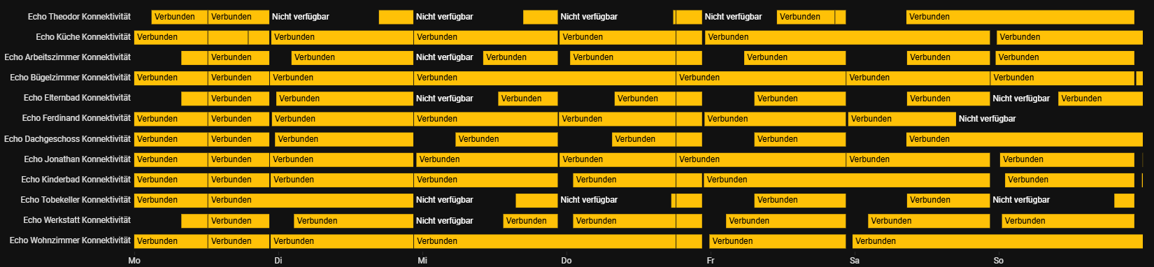

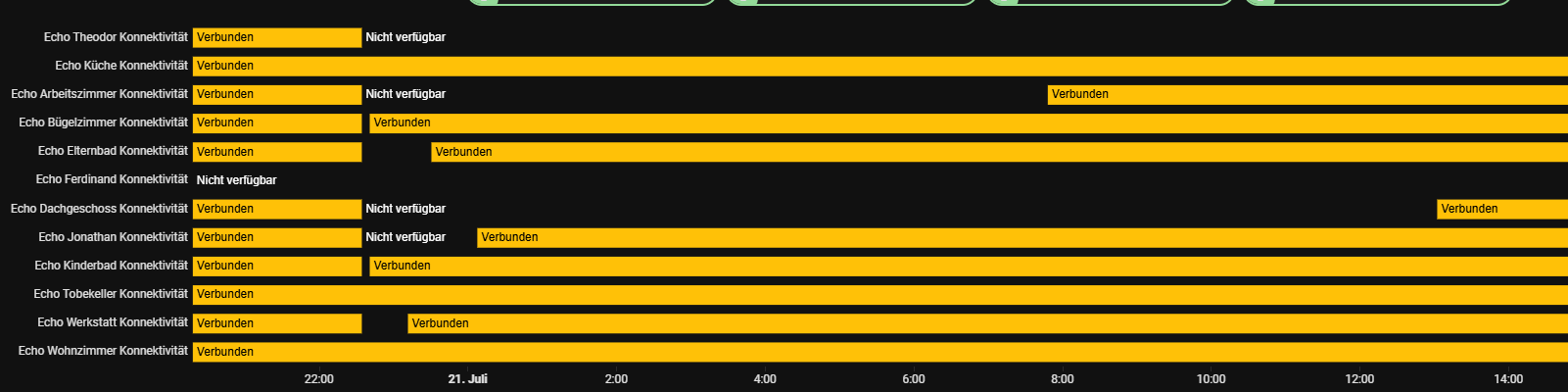

I am using the alexa devices core integration. But I think my issue is amazon cloud related. But I cant seem to find a solution. Every night at 22:30 o’clock my ISP is disconnecting my home. Some of my echo devices can not handle that. Some need lots of time to reconnect (available in Home assistant, online in alexa app) some reconnect only after being spoken to. The unavaiable state in home assistant means offline in the alexa app. When they come back online in the alexa app, they are available in home assistant again.
See here one day:
And here one week:
