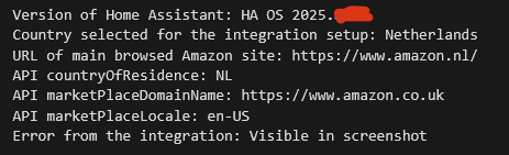

Version of Home Assistant: HA OS 2025.8.3
Country selected for the integration setup: Netherlands
URL of main browsed Amazon site: https://www.amazon.nl/
API countryOfResidence: NL
API marketPlaceDomainName: https://www.amazon.co.uk
API marketPlaceLocale: en-US

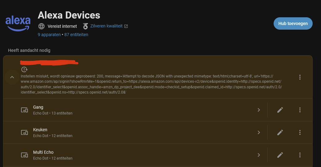

Error from the integration: Visible in screenshot
@Baxxy13 thankyou for the link!
Delete and re-add the integration fixed it.
With version 2025.8.3 and later, we introduced automatic site discovery for Alexa, so we no longer need the country parameter and can handle all the complex scenarios where the account is on one domain, the market on another, and the address on a third.
