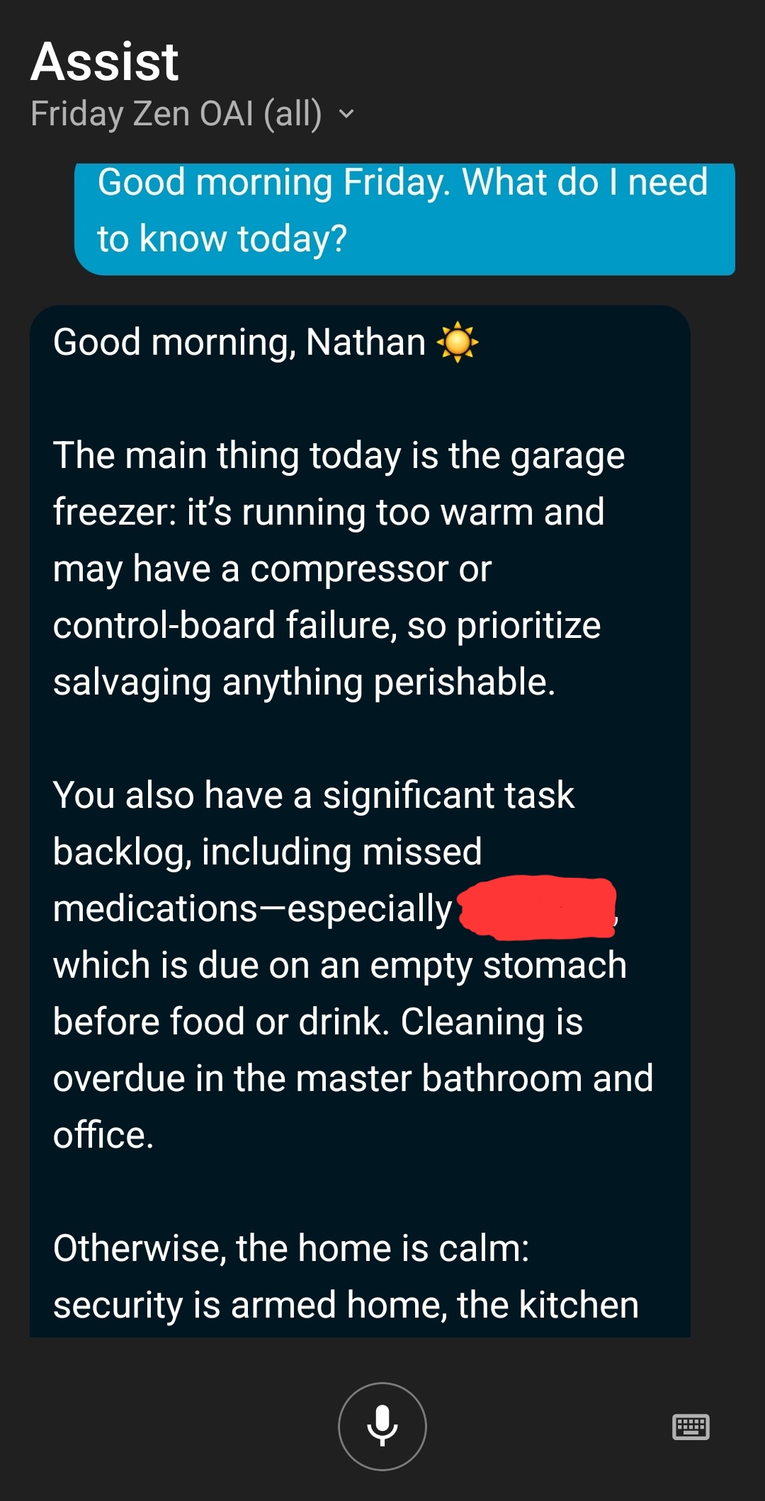

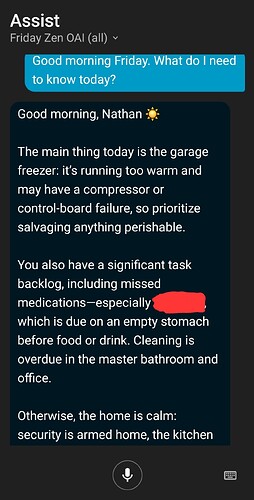

We all want this.
That comes from telling the system your calendar, your chores, your inventory, the layout of the home, who’s home, what day it is, what’s on, what’s off, what missed.
You want Amazon to know that knock yourself out. I don’t.

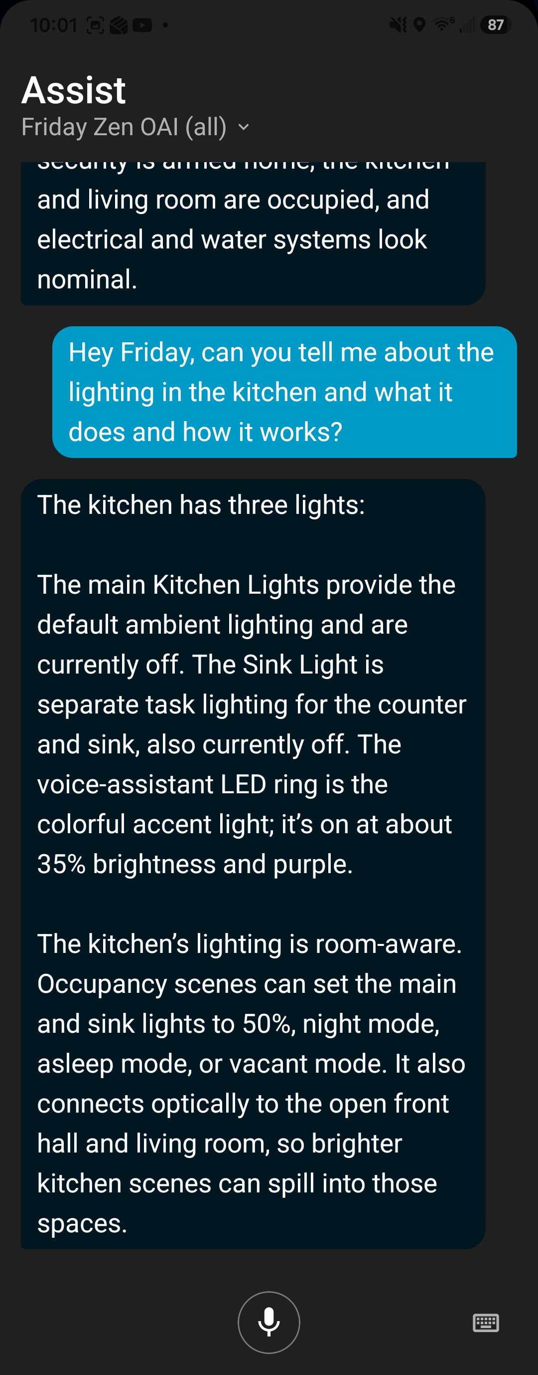

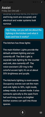

But I do want that so. I had to model it and give it to the agent. Something Alexa simply can’t do… Because it doesn’t have the context…
Because of the description, I don’t have to ask it to target a specific light because she FUNDAMENTALLY understands the location and type of every light and runs lighting ina room as a single action.
the delta here is to make Amazon do that you’d have to have control of yojr core prompt and give it context. And that’s something Amazon isn’t going to give up.
She’s also being over dramatic on the freezer. It’s running two degrees above baseline… :rofl: No worries I control it I can tweak it…

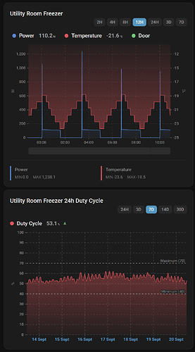

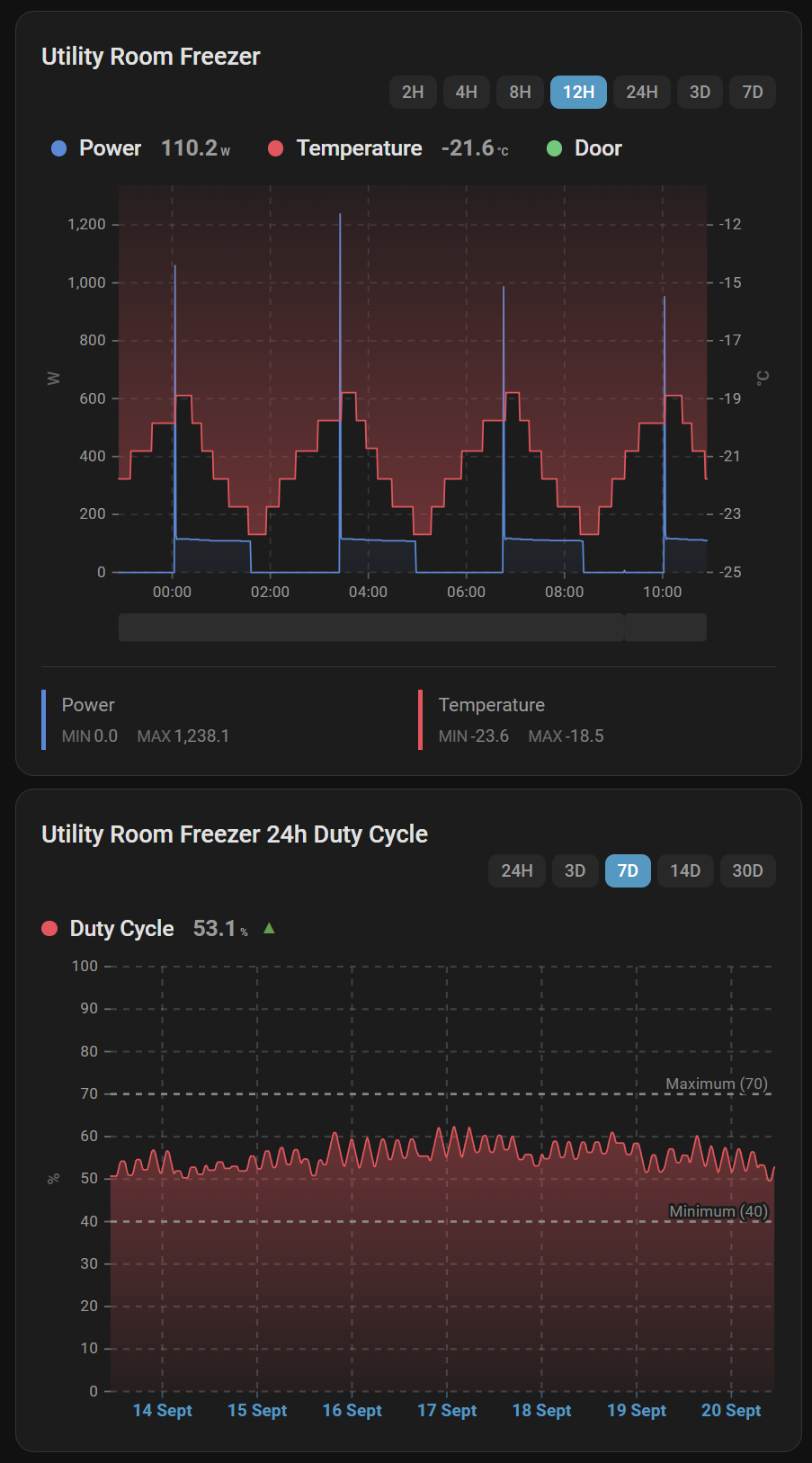

As for the freezer, my lower tech monitoring solution is to monitor temp vs power vs door open (barely visible on the history bar for now), and the duty cycle of the compressor. I can also see when the defrost happens. This freezer had leaked half of its R134A, and thanks to Youtube videos, ChatGPT, etc. I was able repair it. The leak seems to have vanished, maybe fixed by something I did, however it warrants 24/7 monitoring now to ensure it doesn’t die on me. If duty cycle creeps up, even if it reaches set temp, I know something is going on. I have no alerts right now, but that is my next step.
