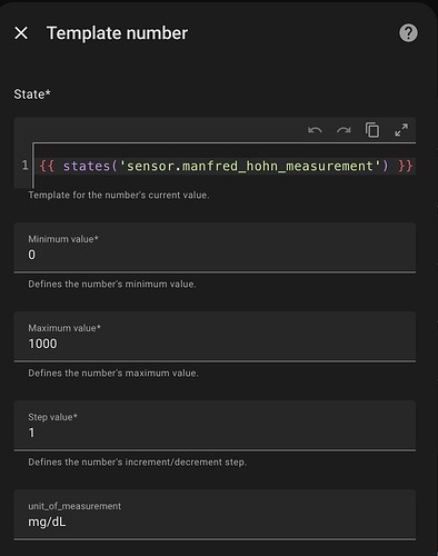

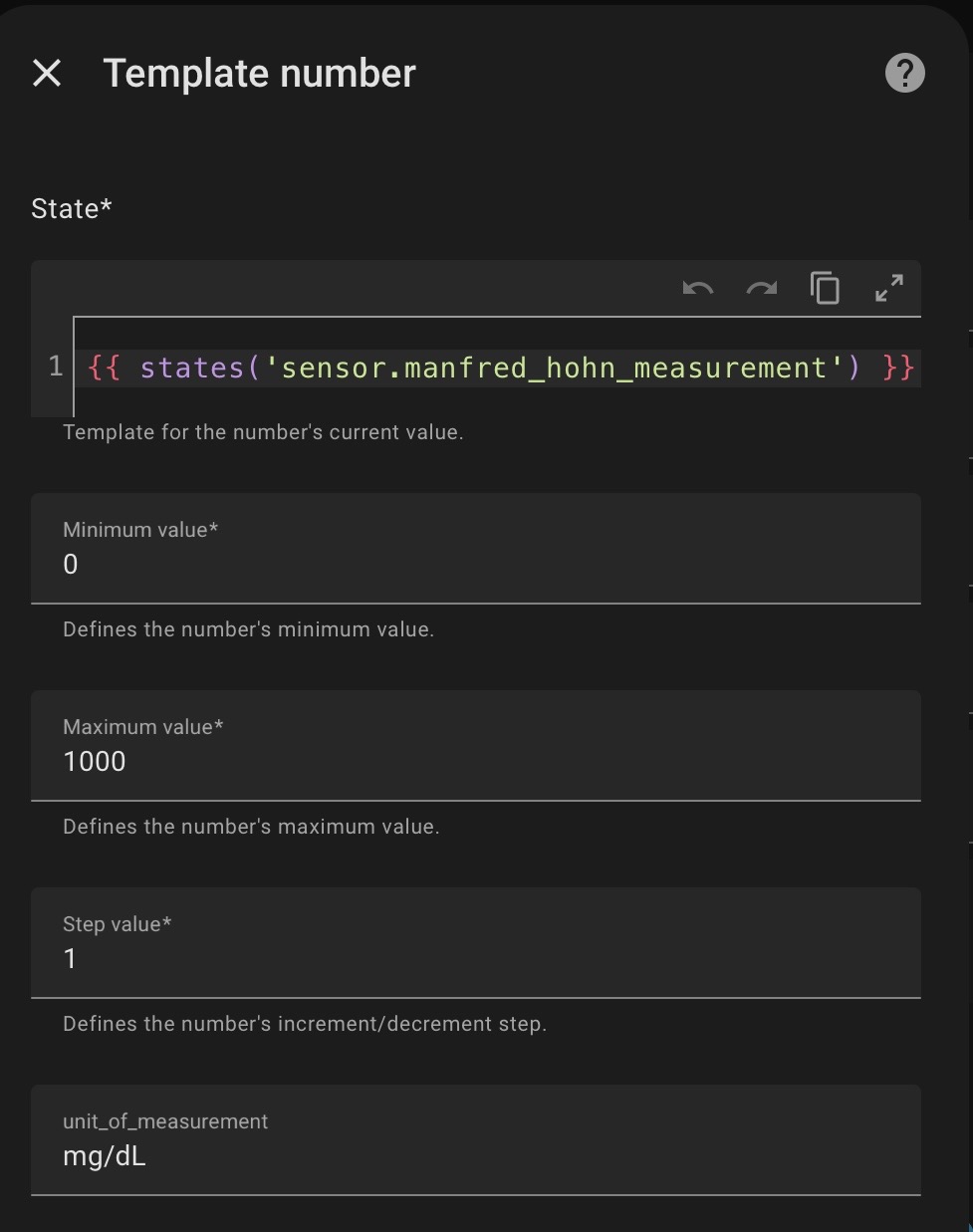

Here is the definition that copies my blood sugar value from the sensor to the numbers helper:

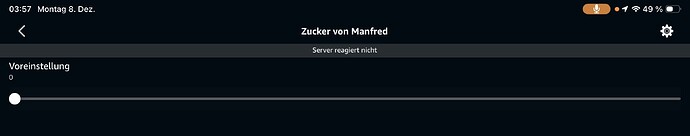

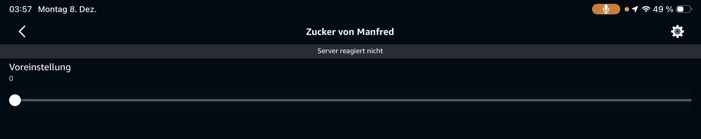

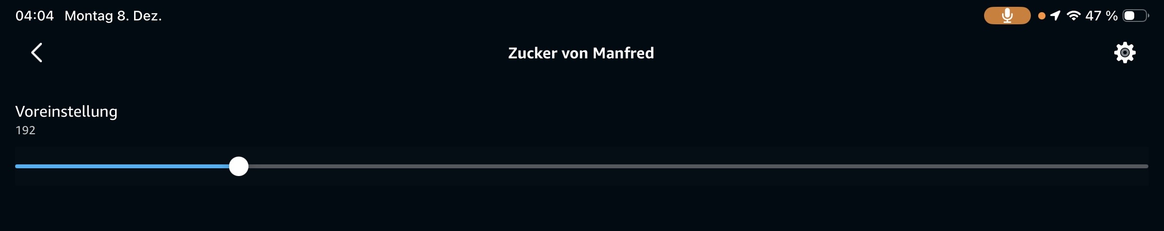

When I import the numbers helper freshly into Alexa app it teils me that the server is not responding (in German „Server reagiert nicht“) and shows value 0 what means that I should be dead :wink:

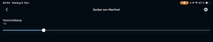

And if I ask Alexa to increase „Zucker von Manfred“ by zero it updates the value correctly and the error message is gone:
But it only updates the value once and I have to ask Alexa again to increase the device by 0 to get the next update.
