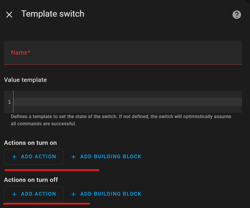

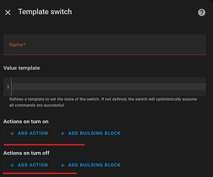

When the interaction isn’t easily understood by Alexa, I generally use a template switch. Alexa clearly understands switch devices.
I haven’t tried it with media player commands. But you have the same ability to define each action.
Have you tested action: remote.turn_on and action: remote.turn_off commands
I’ll test it…

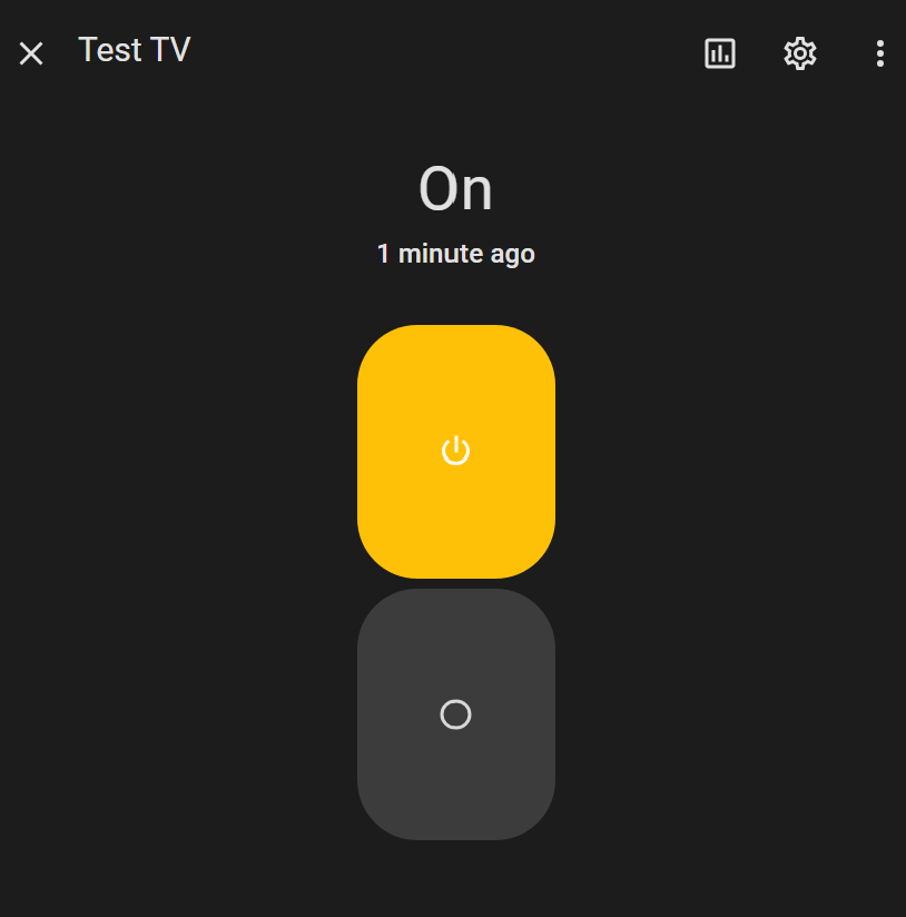

EDIT I tested via a Helper and it works really well with Alexa. You should also be able to eliminate the input_booleans
