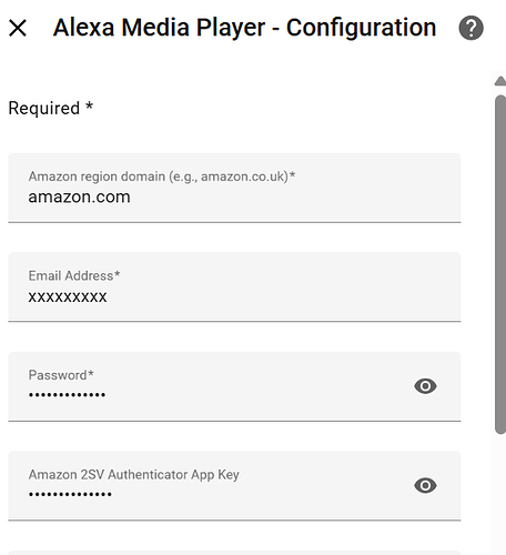

I keep getting this when copying the authentication key from my Google Authenticator:
Invalid Authenticator App key for Amazon 2SV
…sigh… that’s unfortunate…again…:disappointed:
