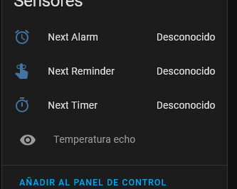

do you have sensors? mine are not showing

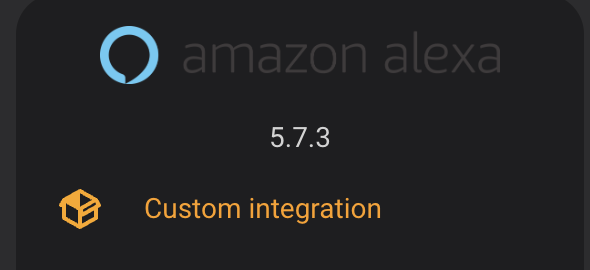

so i guess this isnt over, this update was for avoid asking for credential at reboot , so my guess is someone with no APM previews install will no be able to login
ultil a full fix is made , guess amazon change something else

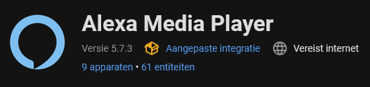

updated to 5.7.3 , but notification still not working (TTS) and I cant control alexa (volume , songs etc…) only see the status …

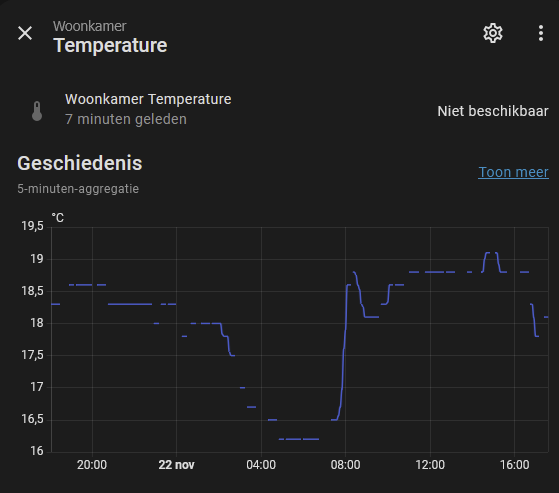

i also had AMP the only thing that is not working are sensors , tts and volume control work as always
Correct, still an issue. The sensors.

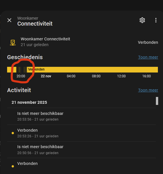

It is unstable when you have polling enabled.

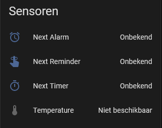

Alexa media player temperature sensor:
If you want to use your Alexa devices only for notifications I advice to use the core integration Alexa Devices. Alexa devices is stable if you turn off polling as well, otherwise it is unstable too.
Alexa devices connectivity unstable if polling enabled:
