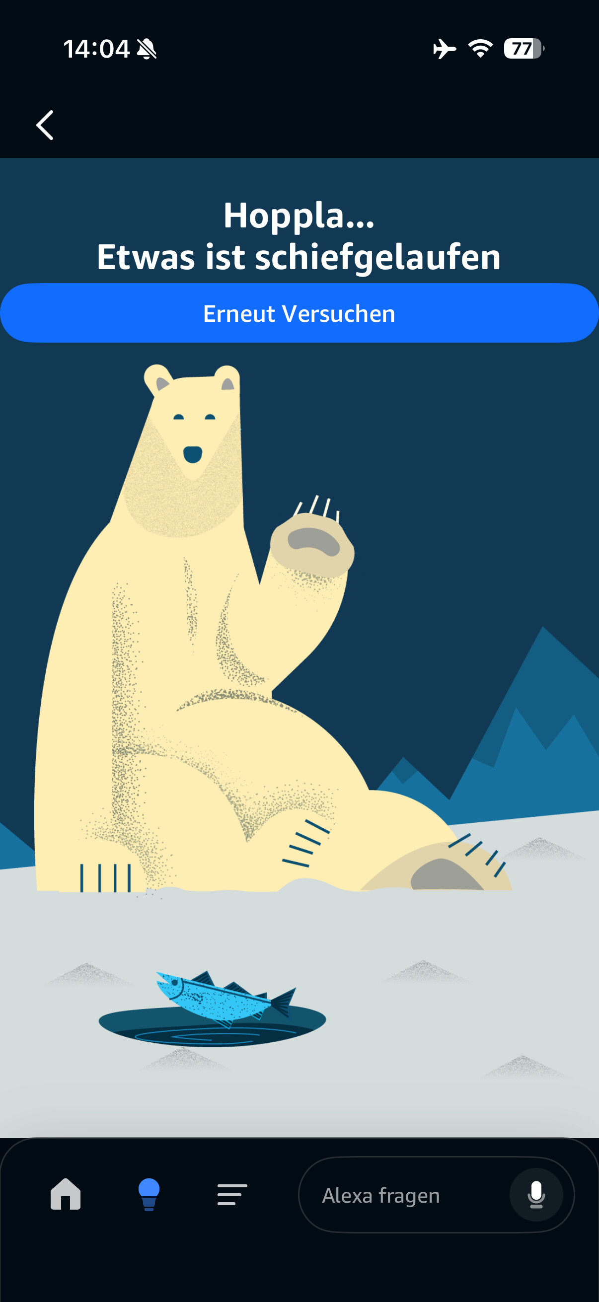

I integrated Alexa with a lambda skill and custom Alexa skill … that’s working great and I control all my switches … now I got a couple of temperature sensors which will show up like this when I pull them up in the Alexa app:
I cannot interact with them, cannot delete them … now the weird part, when I ask Alexa about that sensor she will happily tell me the current temperature.
