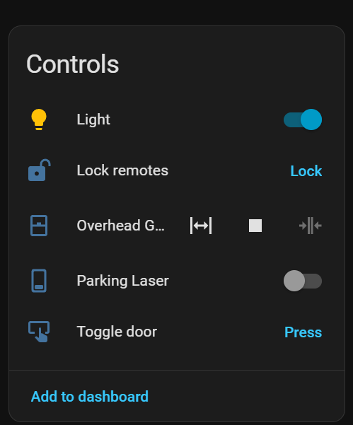

I have a Chamberlain :rage: GDO with a RATGDO.
Recently I updated to the latest HA beta, latest ESPHome version, and redid my RATGDO implementation as mine was customized in a way it was hard to update it (I had to find code changes and change them in my code) - now I use the add/remove/replace functions in ESPHome. I may have made other changes to anything in HA that affected this without knowing.

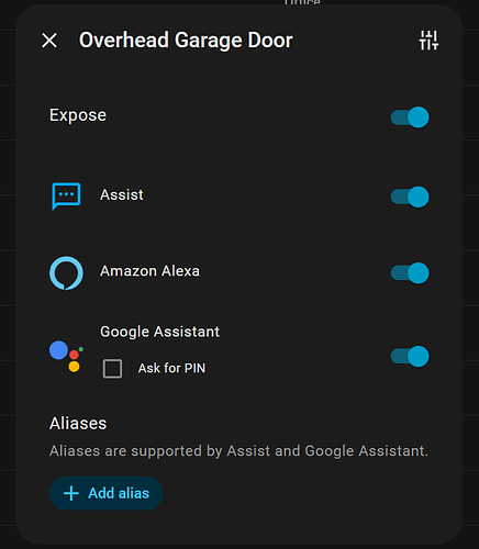

Thinking about it, if the device class “Garage” is what tells Alexa that it is a security device, I could just change that in my ESPHome RATGDO, or I could create a template cover called “Overhead Garage Door” (and thus rename the actual one) and have it interact with Alexa. If Alexa ignores the name of the cover, then it would not be able to tell the difference between a window shade and the overhead garage door if I don’t classify it as such. I’ll have to test this and report back…
PS - Too bad there isn’t the same setting for Alexa:
By changing the device_class from garage to awning in ESPHome (RATDGO), Alexa no longer requires a PIN. I’ll keep looking for an alternative as now the Overhead Garage Door control in ESPHome and alexa app are now incorrect, but that is just nitpicking :slight_smile:
PS: Using shutter as the device_class fixes this in part as the controls in ESPHome are the same used for Garage. In the Alexa app it looks like a shade, but I don’t really care about that as I try to avoid the app as much as possible given it is so bad. :slight_smile:
