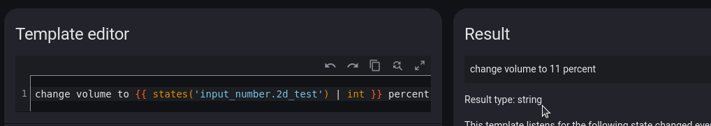

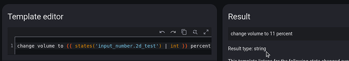

Yes. Test it in the Template editor tool and check the Result type:
versus the result of just the template:
The rest of the text command value will force it to be a string… the int makes no difference.
