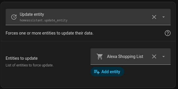

On demand sync should already be possible by calling the homeassistant.update_entity action.
action: homeassistant.update_entity
  entity_id:
    - todo.alexa_todo_shop

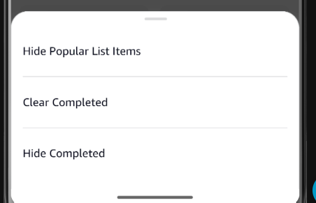

  1. Remove completed items: With this button Home Assistant will just give a list of completed items to the integration. This will result in one API call per item. While this button works for a smaller number of items, for hundreds of items it is indeed not performant enough. I checked the traffic of the Alexa app again: The "Clear Completed " function will also just issue separate API calls per item. There seems to be no endpoint to delete all/multiple items at once. So unfortunately there is not much I can do here for now. Maybe I could add a delay between deleting items, but then it would take forever.
  2. Deleted items are still there: I haven’t been able to reproduce the issue where deleted items continue to sync. The only thing I can think of: the items are being hidden rather than deleted. The Alexa app has two options “Hide” and “Clear”. “Hide” will actually only hide the items locally in the app, but nothing is changed in the backend. Could this be the problem?

Doing some research with Copilot revealed that the Alexa app batches 100 items at a time, and “Clear completed” actually only clears 100 at a time. So it took a while to get 8K items deleted.
