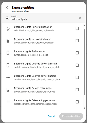

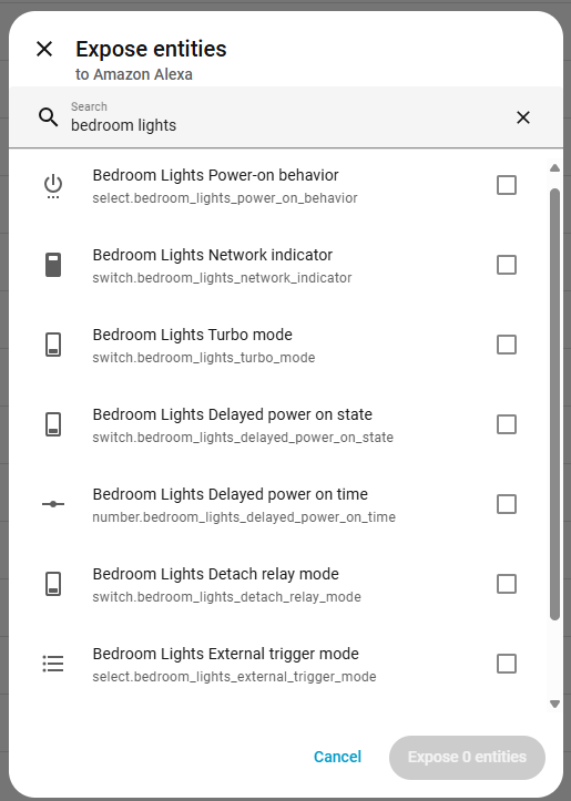

I am wondering if I need to expose more entities. Here is the list of available additional entities to expose

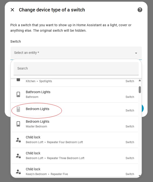

HA UI >> system >> settings >> devices and services >> helpers (tab at top of screen) >> create helper >> change device type of switch
If this device is actually a light you should use helpers to change it to a light. It corrects its appearance in UI and allows HA voice to properly control it. It will also ensure Amazon see it as a light. Since you are newly adding the device now is good opportunity to prevent what could be long term trouble.
Many thanks @tmjpugh that has finally resolved it. I had to remove the exposure in Voice Assistant and then remove the zigbee relay from Z2M and reboot the system. I then added the relay back and re-exposed the entity in Voice Assistant (which incidentally shows a phantom bedroom light (see below). It then showed in the Alexa app but was not controllable. As soon as I added the helper Alexa asked where the new light was and it all work again.
