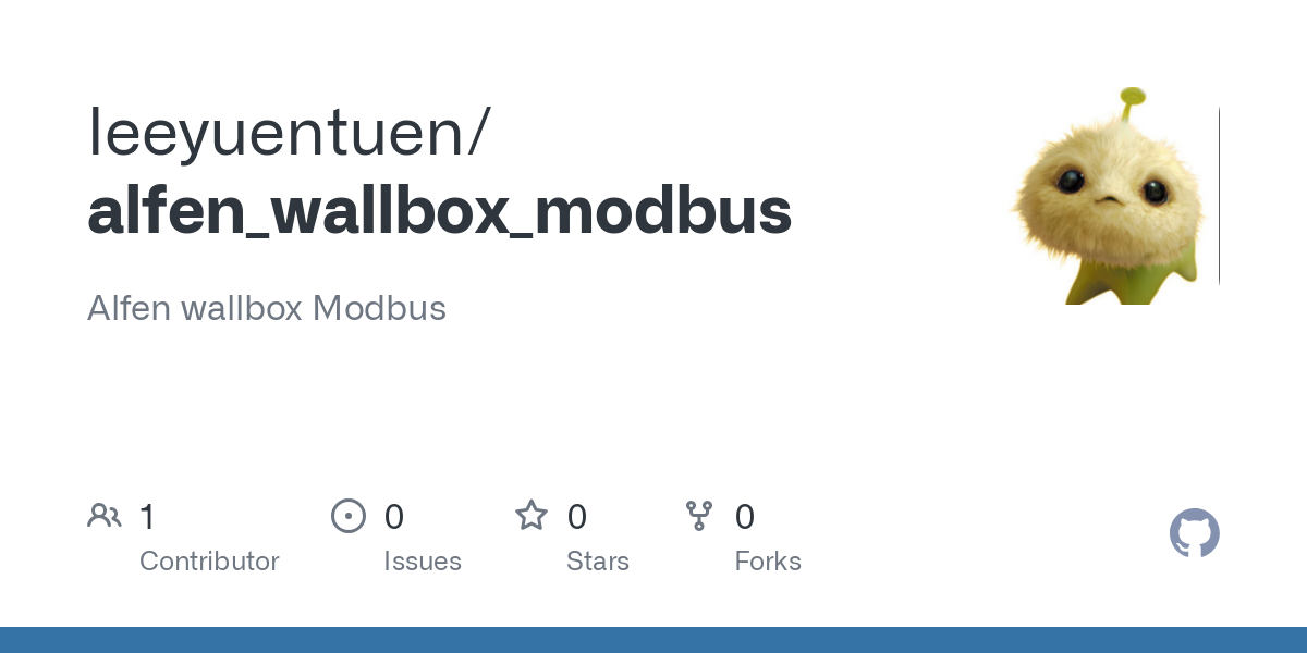

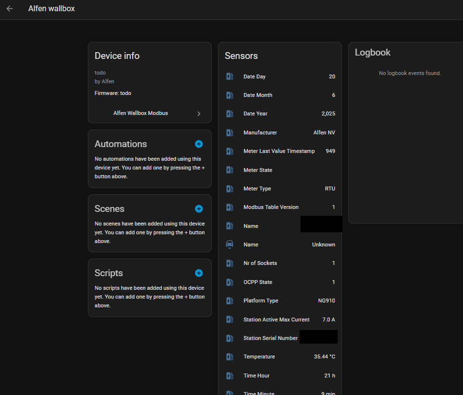

Just start new project (still in alpha) to use TCP Modbus in home assistant
advantage: multiple connection possible
disadvantage (atm) only read, no update.
still just a start, still need to add more address based on the documentation

Are you still considering resuming this? The other option: GitHub - ThaStealth/alfen_modbus: Alfen Modbus Component for HomeAssistant
Hasn’t seen any recent development and doesn’t seem to work right now.
could you please continue? The ThaStealth integration is not working well anymore and it looks like it is discontinued

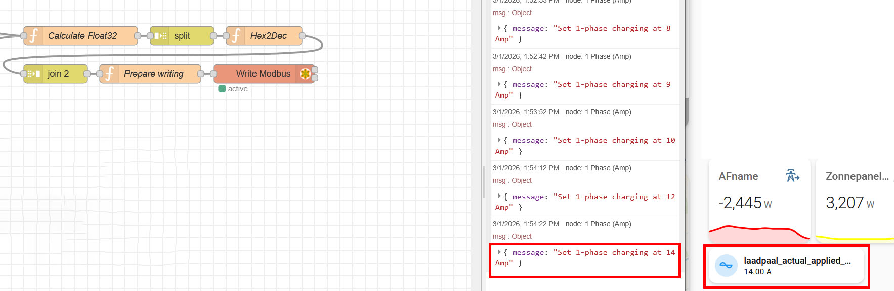

Hi Luuk,
Your node red config for writing the max Amps to the charger works like a charm!

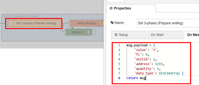

However, I’m not able to write 1 or 3 phase to the charger via Node Red
 Any idea? I can read the register (address: 1215, datatype: uint16), but I don’t know how to write the value “1” or “3” to that address via Node Red
ChatGPT was actually useful:
