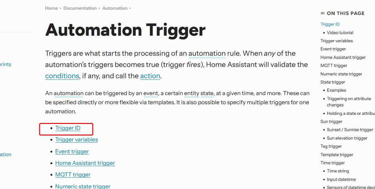

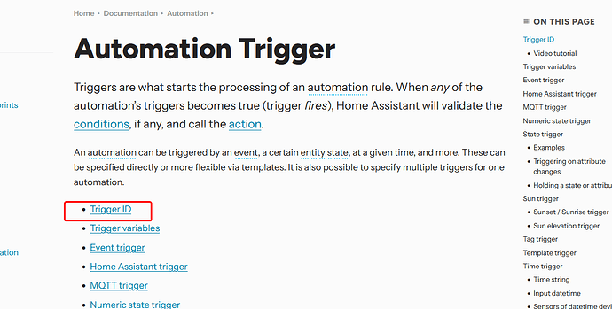

It’s covered in the first section of automation trigger
and the code would be:
      triggers:
        - trigger: time
          at: sensor.entity_1
        - trigger: time
          at: sensor.entity_2
      variables:
        next_mode: >
          {% if trigger.id == 'alias_1' %}
          # the rest of logic
