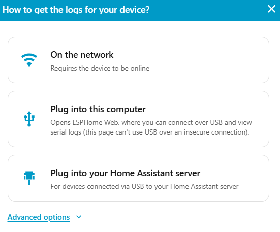

If restarting didn’t solve the problem then try plugging one of the esp devices into your computer with USB and in ESPHome app select logs and then select Plug into this computer.
The logs may give a clue.
