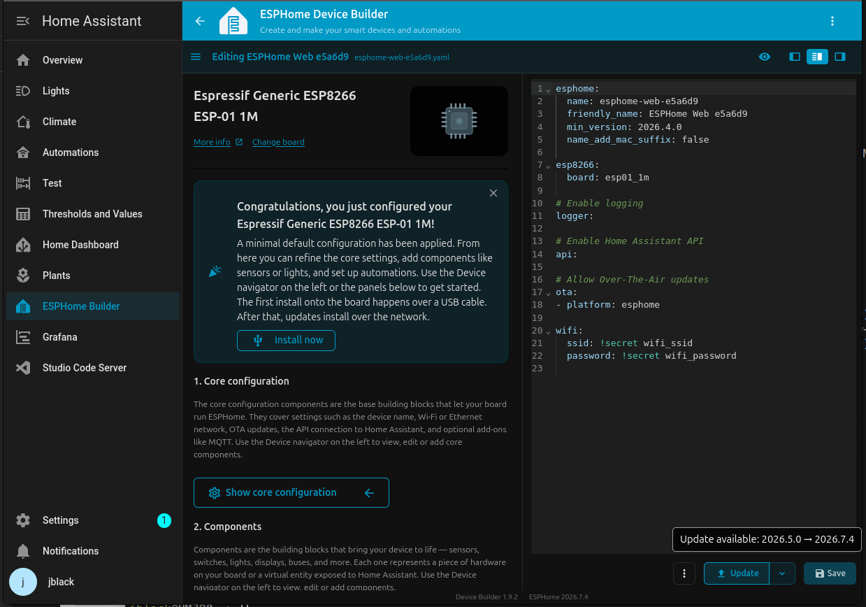

Update is the option that shows up when I go to the YAML edit page in device builder (bottom right corner):

To be clear, this is not my YAML, it’s the default that Home assistant/ESPHome/device builder creates when it takes control of a discovered device, I haven’t touched the YAML at all, which is why I’m confused.

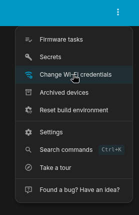

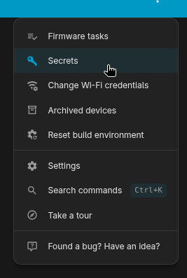

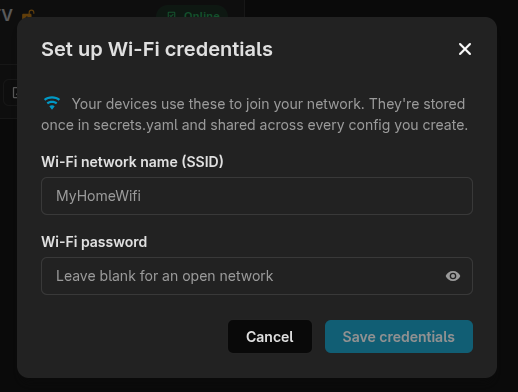

In the latest ESPHome Builder you can even edit this:
OR:

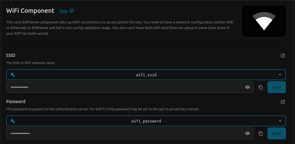

So this is interesting, replacing both the ssid and password with strings in quotes, rather than !secret variables did actually solve the issue. However, both my ssid and password variable are absolutely, without a doubt, correct, and if I use the variable in either one, I’m back to being unable to see any networks. Maybe a bug?
Maybe your password includes some characters that not render correctly, you may test first to press Validate before Install to see how the rendered yaml file looks like.

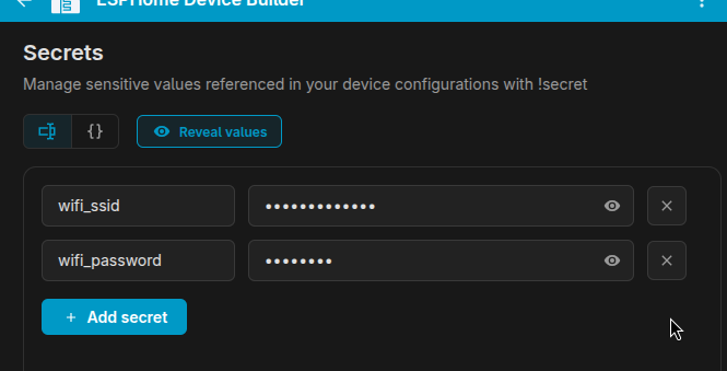

So you get like me, the secrets editing feature in ESPHome Builder.
