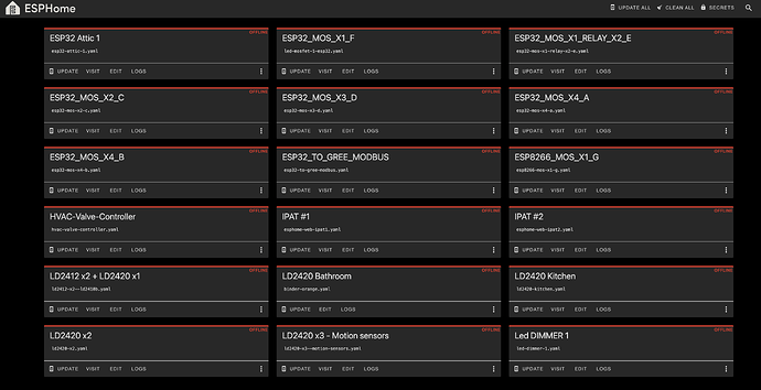

All ESPHome devices are not connected anymore to wifi, their fallback hotspot is active
Hello everyone,
Today the power grid was disconnected again, this happen last week once too, does anyone know what could cause the disconnection of all my ESPHome devices (15 different kind ESP32, ESP8266).
Each device has it’s Fallback Hotspot active , I tried to login, selected the wifi , inserted the same password … but still nothing, it can’t connect.
Nothing changed in the past 6 months, since January or february I haven’t checked HomeAssistant and I haven’t updated it, I did this a few weeks ago, one update only, today after I noticed all ESP are disconnected I updated Home Assistant Core and Home Assistant operating sistem to the latest, the tablet dashboard works just fine, but all ESPHome devices are offline.

I noticed that all devices in ESPHome Builder have the UPDATE button active (Update available: 2025.12.2 > 2025.12.7 or on other devices 2025.12.4 > 2025.12.7 )
It is very weird to me why all devices don’t work, the wifi password did not change, the wifi SSID did not change. The wall mounted tablet works just fine, connected to the same wifi. RaspberryPi is connected via LAN.
Can there be some incompatibility in the 2025.12.2 or 2025.12.4 firmware with the latest Home Assistant versions that could make them not connect to wifi?
