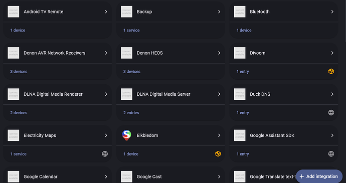

I’m kinda new to ha so I don’t know what card config is. If you’re talking about a dashboard card, that’s not the problem. Here’s a screenshot of my integrations page to show what I’m talking about:
The ones with icons are things I set up or had an update after I restored from the backup.
You have a “brand icon” issue. Try opening the page in your browser’s private/incognito mode.
