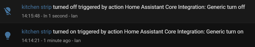

"Dimmer turned off triggered by action Home Assistant Core Integration: turn_off"
This was the message all the lights had on both days. I've only seen that message from the emulated hue Harmony integration so I'm leaning towards that. But not clear why that would that configuration would be causing issues. I've had it for the last 6 or so months without issues. 2 days ago, I assumed someone touched the remote and that caused it to go haywire (no logs to check on the Harmony side). However yday, noone touched the remote and it happened again. So I'm lost.

Then it's 100% what I told you yesterday. You have a homeassistant.turn_off action being called and the targets are either not defined, or else they're defined too broadly (like targeting an entire floor or label).
I just tried this by calling the homeassistant.turn_on & homeassistant.turn_off actions in Dev Tools & can confirm that's exactly what is reported in the Activity log.
Usual suspects for this are (poorly coded/misconfigured) blueprints. Search both the automations.yaml file & the blueprints folder for any reference to an action starting with homeassistant.turn
