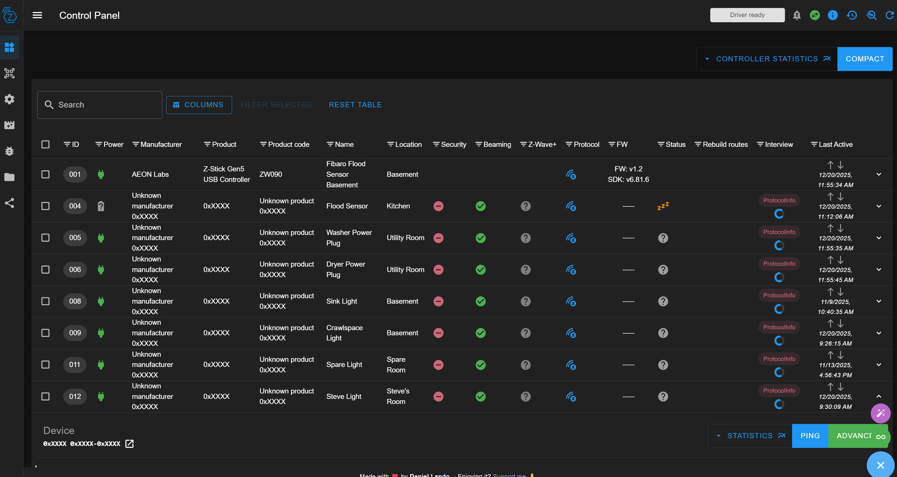

I have a AEON Labs Z-Stick Gen5 USB controller plugged into a Windows computer and running ZWaveJS UI. My HA instance connects to it and can manage all my light switches. Been working great for a long time. After a reboot of the computer, the ZWaveJS UI comes up but all the routes are failing even after a rebuild and reinterviewing nodes just spins forever and never populates any data.
There are more nodes but what I screen captured shows:
Any thoughts?

I haven’t changed anything, just rebooted my computer. Thanks.
Note apparently restarting the service, rebooting again, trying to do everything I mentioned doesn’t help. I unplugged the stick from the computer and plugged it back in and poof things started recovering again.
Yes, sticks can get into a failure state and require a power cycle.
