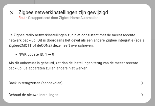

After a while devices started behaving a bit strange and I got following warning (zigbee network settings have changed):
Even when restoring, the devices remain offline.
I tried to restore a backup from two weeks ago. But once booted, same message appears again.
I can retrigger the situation by moving the zigbee.db file from the backup to the config directory in home assistant.

When ha core starts, the same message appears again.
