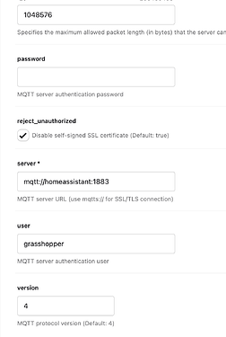

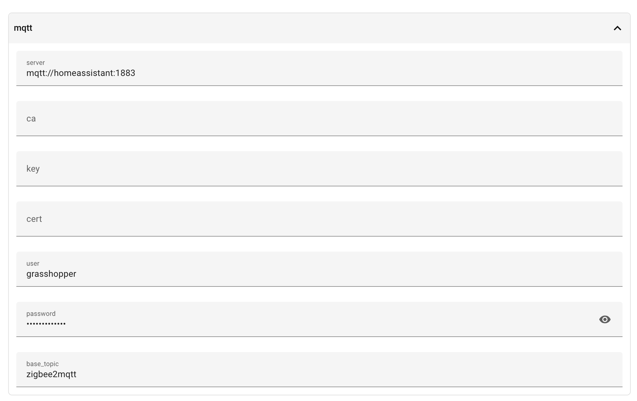

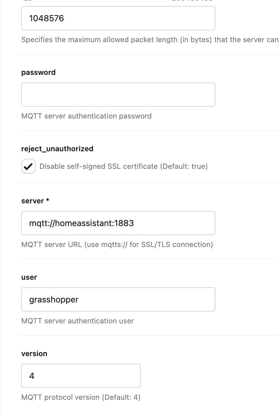

Something that stands out, from the EMQX log:
EMQX_NODE__NAME [node.name]: [email protected]
And this from within the Zigbee2MQTT add on settings page:
Note server address.
I haven’t changed the server address at all, so I don’t know why this happened. I gather this needs to be changed in the addon configuration page as I see no way of updating the server address within the addon. So maybe here…
The address is homeassistantonmac.local (this is a new home assistant server I am migrating to).
yeah, that was it … the address got changed somehow. Thanks for the feedback guys… it is really appreciated…
