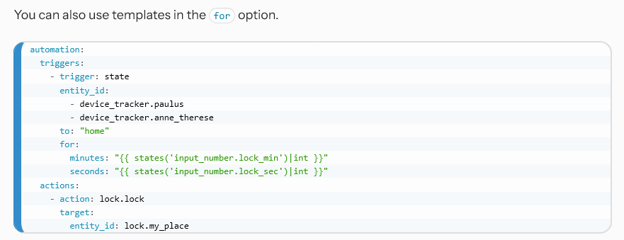

Not true.
Already possible, please refer to the trigger documentation:
https://www.home-assistant.io/docs/automation/trigger/#holding-a-state-or-attribute
