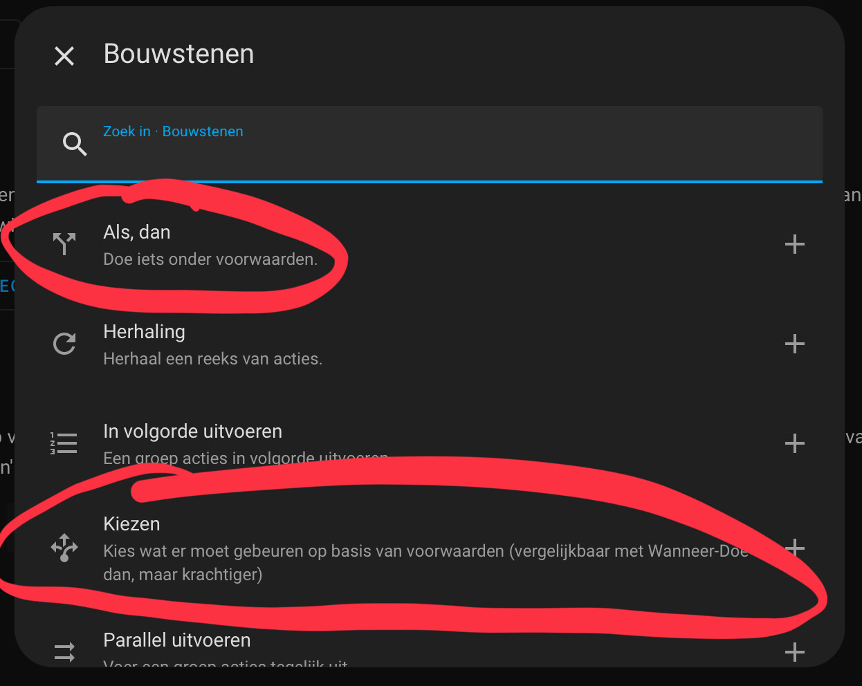

What is wrong with the if / else or choose actions? They can handle things like these just fine. In the automation editor they are called building blocks. If you use trigger id’s you can also react differenly on which trigger fired.

Yep there is a misunderstanding… Build triggers that capture all scenarios then restrict what actually runs with conditions.
Trigger change then condition true/false

In one automation you can have it triggered on the value changing at all, or only to something specific, and then you can have multiple nested conditions up the wazoo so what you are asking is already included. Even in the action you can put nested if-then conditions as well. And, you can have numerous different triggers for the same automation too.
The sky’s the limit, what you are alsking for is already there

As I understand now, I have to listen to all changes of the entity or template and then in the building block do one or another thing.
One automation can do this:
  • Two triggers: 10pm and temperature dropping below 25.
  • Two conditions: between 10pm and 5am; and temperature below 25.
  • Two actions: one to turn on the kitchen fan; one with a condition that you’re away to turn on the other fans.
Typically you do not have to add triggers for all changes - just list the property you want to trigger on and then put nothing for the value to trigger on - it wll trigger then on any change
