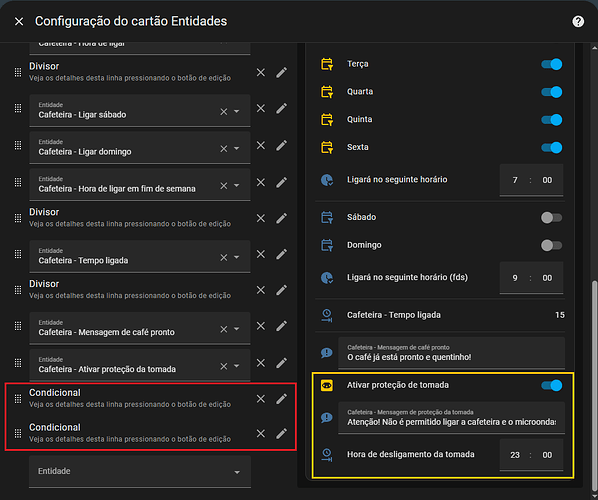

Ex. 1 (When disabled, this panel is only visible.):
Ex. 2 (When the entity in the first panel is enabled, the second panel appears with more options):
Ex. 3 (When the “scheduled restart” option is enabled in the second panel, the third panel appears to enable the days of the week when the system will be restarted, the time and to which smartphone a notification will be sent. It also has the type of restart - whether only HA or the entire system):

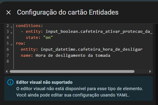

Why not using a stock conditional row?
@ Ildar_Gabdullin
Ok, what’s a conditional row?
Alright, I looked it up and was tricky to get the syntax but some examples helped, and I got that working!
Thanks for the tip!
You are right. This “conditional” option works.
However:
  • You lose visual editing (you are forced to write code).
  • You cannot create a condition that applies to multiple rows. If you want the same condition to show or hide multiple rows, you have to repeat the same rule on multiple different rows.
This would be easily solved if they created this property in the visual editor.
And it would be even better if, in addition to visibility, we could configure the row to be “enabled” or “disabled”.
Although it is feasible, if I use this option for my complex panels, basically all the code will be manual.
