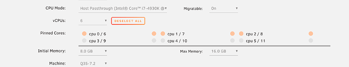

So, for hardware point of view. I am running HA as a VM in an Unraid build I have done. I have set it to 6 CPUs, Memory 8192M, 32G Vdisk. Further Hardware : Running Mobo Gigbyte X79-UP4, Intel Core i7-4930k CPU @3.40GHz, Memory 32GiB DDR3. I am only running a Plex Media server in a docker next to HA. Unraid is running 7.1.4 (there is an update avialable, but thought to leave it like this for now, should this impact any other questions you might have).

If this helps, my VM in unraid is setup so it has a minimum of 8GB (initial memory) and a max of 16GB.

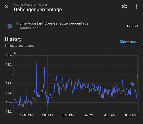

However, the sensors are still hidden, I was unsuccessful in installing the Supervisor in the configuration.yaml, but when I was looking more in integrations, I did find it and even enabled CPU and Memory percentage for Home Assistant Core.

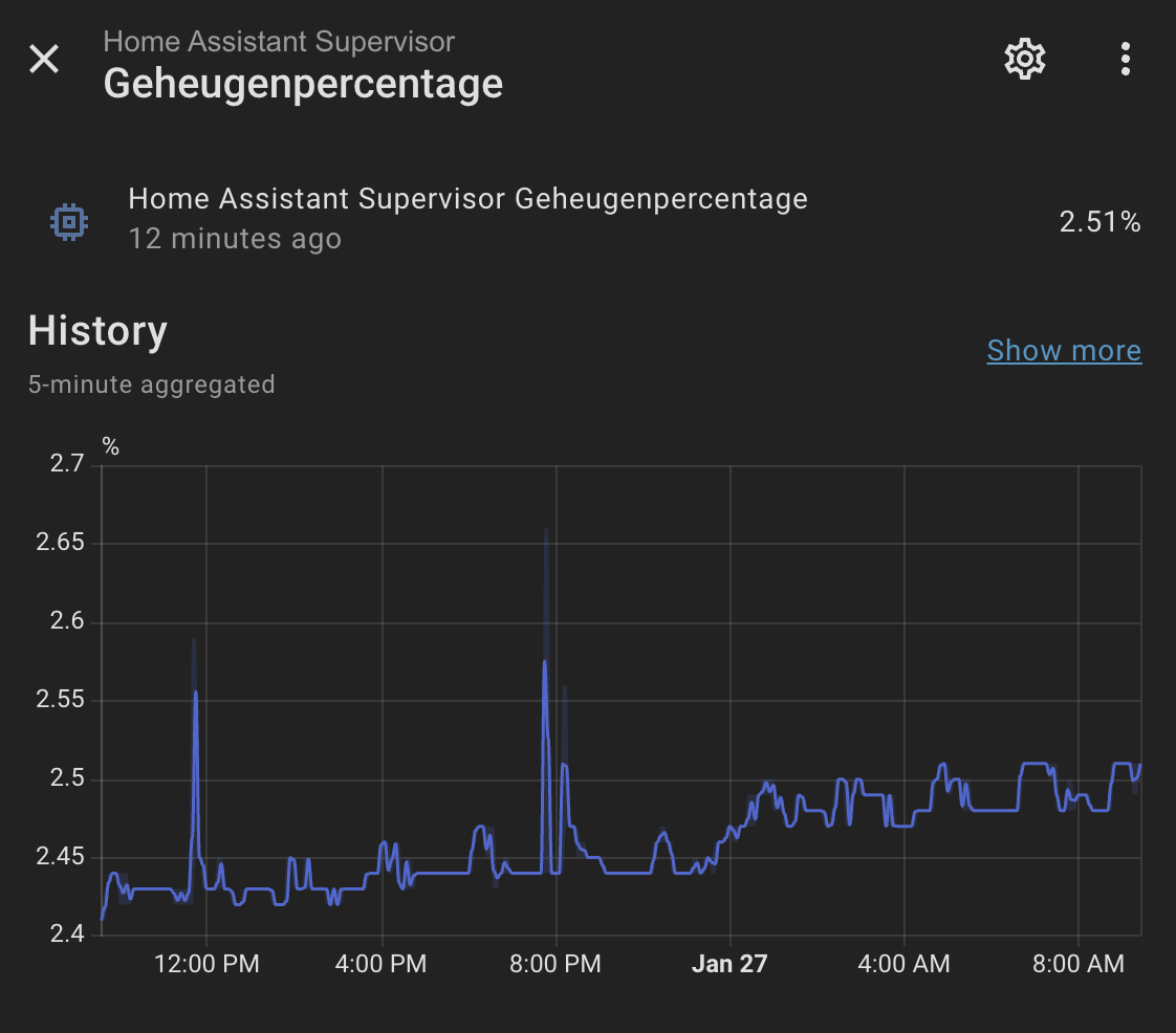

I did enable the sensors in Home Assistant Supervisor too, but the Memory usage in that one, seems a lot lower, as does the CPU percentage.
I am hoping that if I wait a little, the graphs will be filled, but right now, they still appear empty.

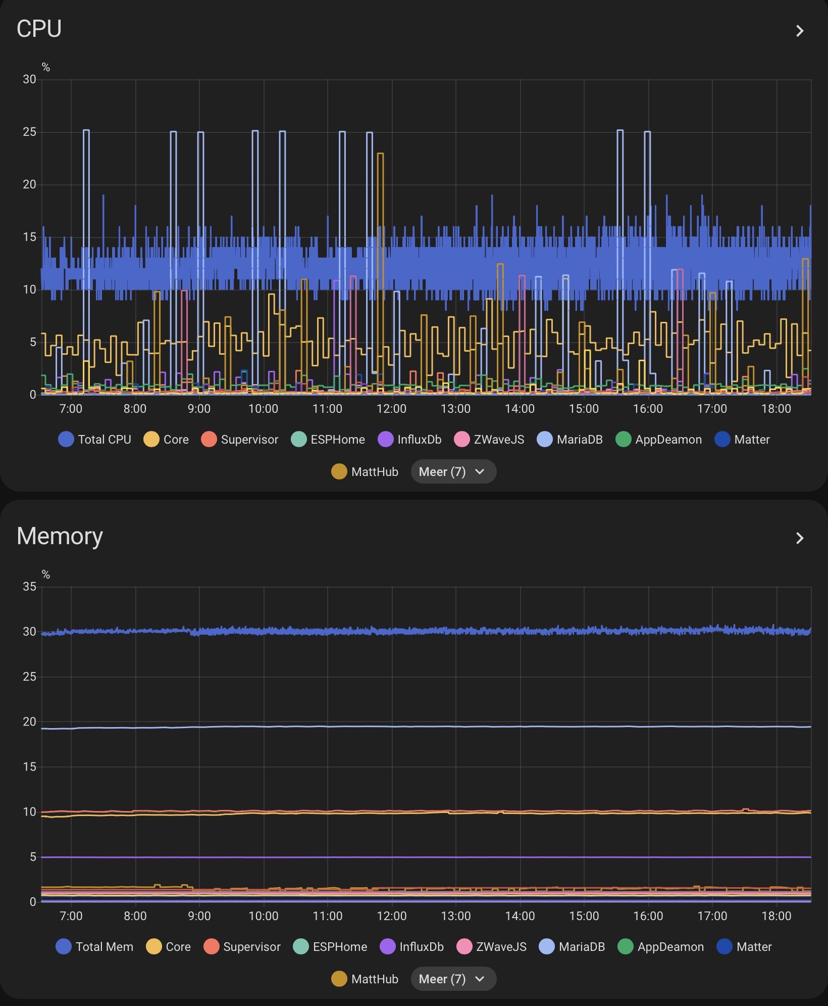

So, as promised, I have hereby let the graphs compile for a few days and it doesn’t seem to be off from my point of view?
Does this help in narrowing down the issues I am experiencing at all? Or can someone suggest another path to follow please?
