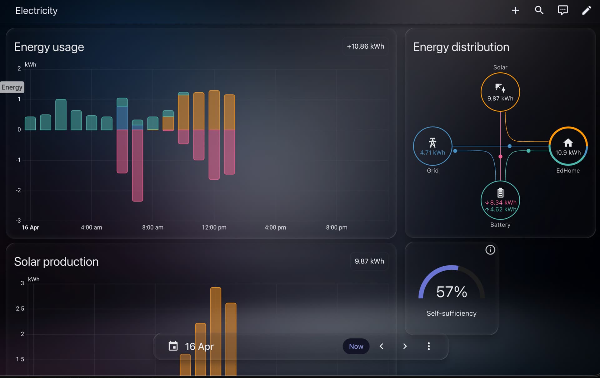

  • Zero-Config Energy Dashboard: I wanted this to be “plug-and-play.” The integration automatically handles the Riemann Sum math for you.
  • Automatic Energy Helpers: It creates energy sensors for Solar, Grid, and Load out of the box.
  • Smart Battery Splitting: It automatically splits bidirectional battery power into separate Charge and Discharge sensors—a must-have for the HA Energy Dashboard.

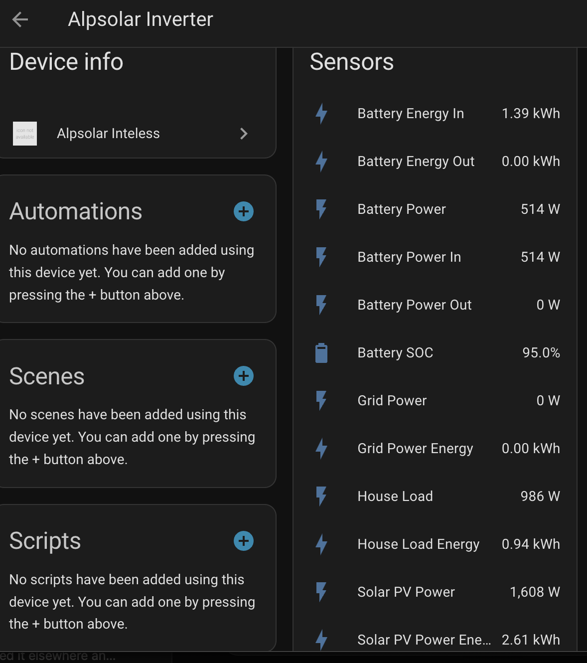

:bar_chart: Entities Included (12 Total):
  • Real-time Power: Solar PV, House Load, Grid Power, Battery SOC, Battery Power (In/Out).
  • Energy (kWh): Solar Energy, Grid Energy, Load Energy, Battery Energy In, Battery Energy Out.

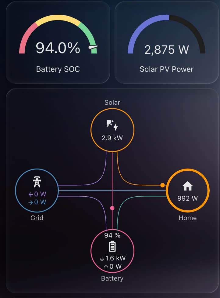

Powerflow Card Plus view
