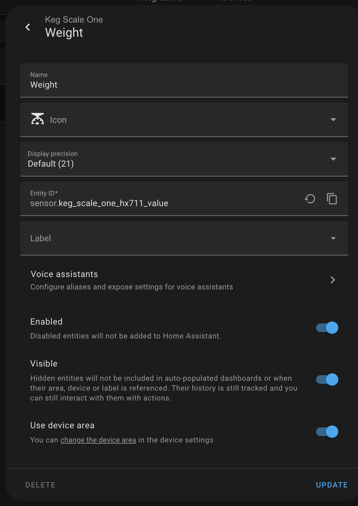

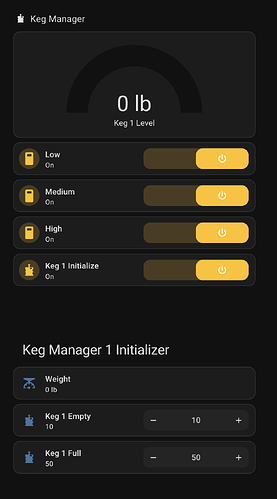

It doesn’t seem to be working though. Both the scale weight in lbs and the gauge are still reading the same thing…

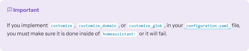

https://www.home-assistant.io/integrations/homeassistant/#manual-customization
homeassitant:
  customize: !include keg-management-system.yaml
Are you sure you are customizing an existing sensor?
The YAML code you have copied (although not correctly formatted) looks to me like you are trying to create a new template sensor based on the existing one.
Shit. I missed that. Yeah that is not a customise include.

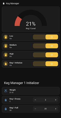

Thanks for all your help. I updated my config file and template file. Still looks like it’s not calculating the percentage correctly though. The % is still the same weight as lbs.

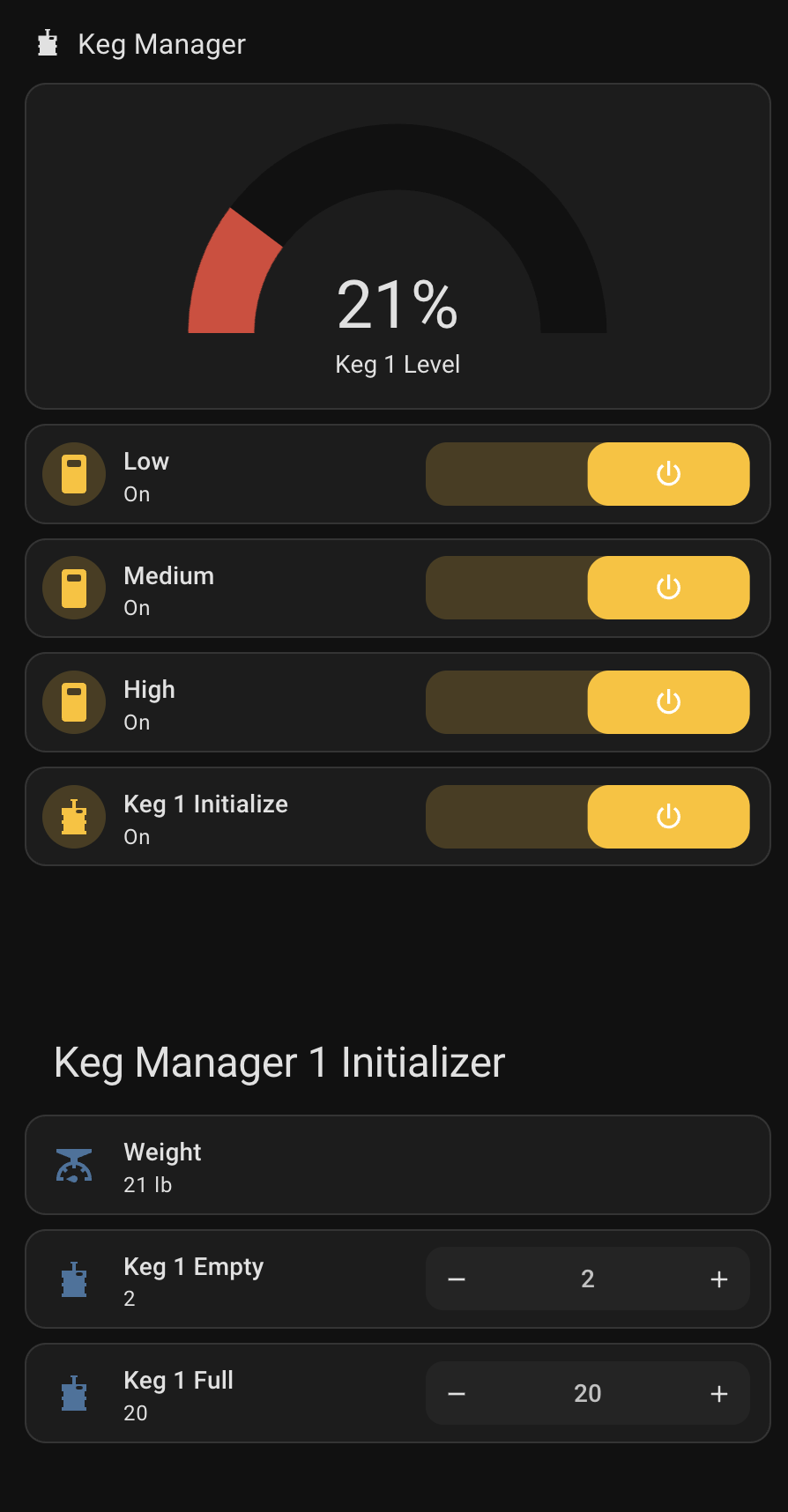

Oh wait I think I figured it out! I see the template as an entity now and can change the gauge to us it! Thanks and thank you for your patience!
