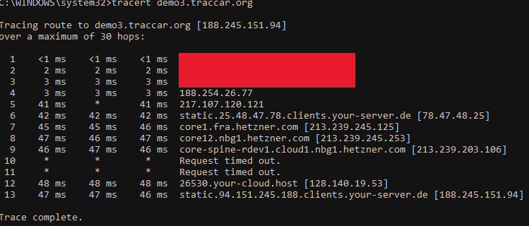

Can you ping “http://demo3.traccar.org/” - is it a DNS issue? Routing?

It is pinged.

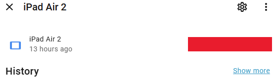

Look, an iOS device is inside LAN, is being used quite often (i.e. not always with disconnected wifi), and it stuck in a place I had been a few hours ago, no updates:
If I open Companion App - it usually updates the location. But sometimes I need to press “update data” button in the App (wrote about it earlier). So I am not sure that these glitches are “local in my country” (see these glitches since 2020, by the way, before the war).
