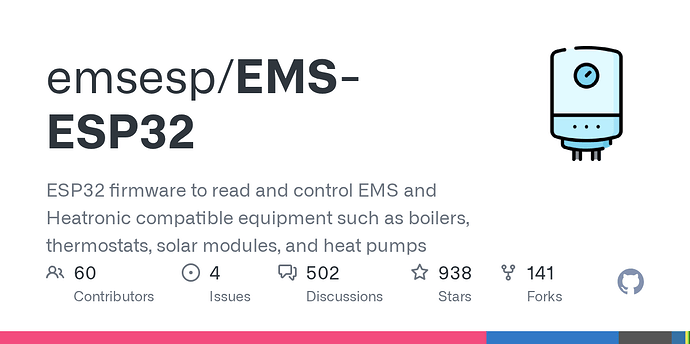

Maybe you don’t need a Shelly, but an EMS interface?
A little light reading for you:
https://emsesp.org/Home-Assistant
https://emsesp.org/
https://emsesp.org/Getting-Started
https://bbqkees-electronics.nl/wiki/gateway/connecting-to-specific-boilers-and-heatpumps.html#greenstar-8000
https://emsesp.org/tips-and-tricks
Disclaimer: I have no connection with any of the items listed above, either intellectually or financially. I just found there is a rich set of commands already built into your Bosch unit that you may be able to harness for peak efficiency via the EMS interface and closely integrate into HomeAssistant. My earlier comments regarding deploying DS18B20’s still apply, and you may be able to customize the code to include these sensors with your EMS ESP32 source code and send them with your other MQTT data, or just simply use another ESP32 - they are quite cheap.

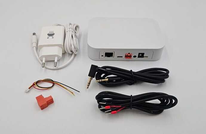

Already own the BBQKees unit, just haven’t gotten round to installing it as I have to get into the loft and take the boiler cover off in a confined space.
